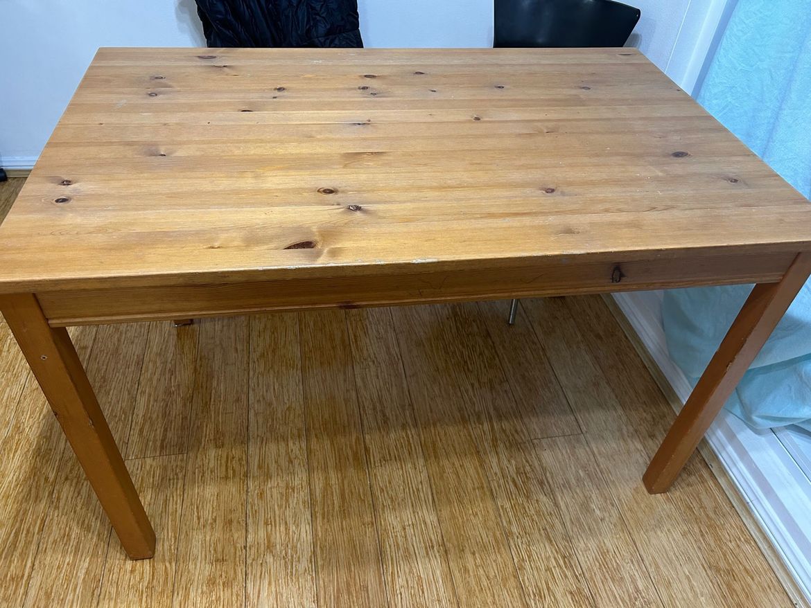

However, before we proceed any further, would it be possible for you to post a photo of the table. This will give our members a chance to assess it. We can then make recommendations on what you can do to further protect your table.
If you need a hand posting the photos, please let me know.
Hi Eric,

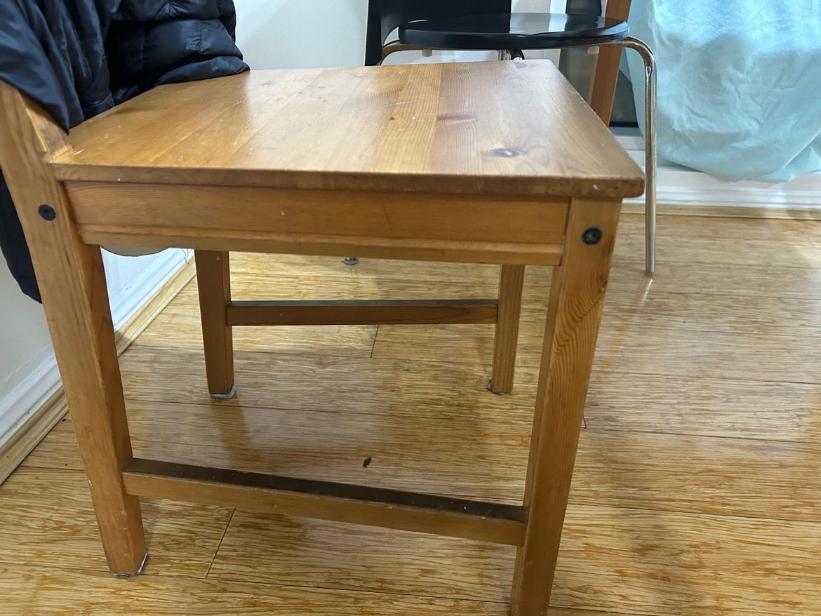

Thanks for replying. Below are the pictures of the table and also the chair which is made of the same wood material. Basically this is from Ikea.
Hello @adrianyung
Thank you for posting photos of your pine table. In order for the Bondall 1L Gloss Monocel Gold Marine Clear Timber Varnish to bond properly to the timber surface. It'll be necessary to sand off all the current varnish on the table and chairs. I suggest using an electric sander to make it easier to prepare the table.
This would also be a good opportunity to repair any damage with filler and tighten up the screws of the table. I recommend a minimum of two coats for optimum protection.
Here is a handy step-by-step guide: How to restore wooden furniture.
Please remember to wear personal protection such as gloves, goggles and a mask while working on your table.

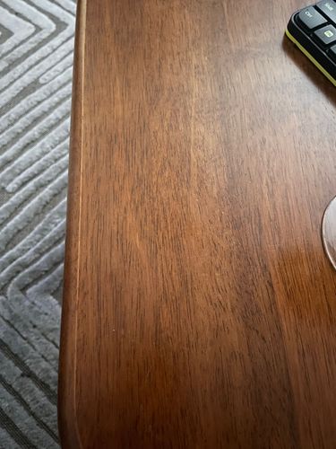

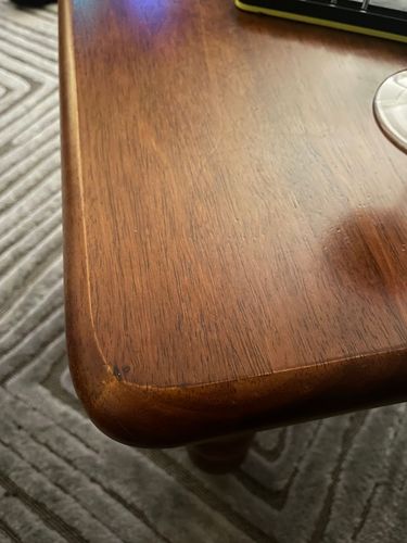

Hi
The main description says
But in the Bunnings product section it says Mo to UV. Which one is it? Assuming the SKU was wrong and it is UV resistant.
I also ideally want to apply this directly to a well looked after varnished indoor coffee table and would prefer not to prep the original varnish. Wondering if this stuff will bond well on top of a good varnish.
Thanks!!!
Steve
Welcome to the Bunnings Workshop community @bluejam00. It's brilliant to have you join us, and many thanks for your question about varnish.Being an exterior varnish, the Bondall 1L Gloss Monocel Gold Marine Clear Timber Varnish is most certainly UV resistant, and that would be an error in the specifications section. I'll have our team adjust that for clarity.
An exterior varnish wouldn't be suitable if your table is for indoor use. Or are you planning on placing it outside? It sounds like you might be, given that the current varnish is in good condition, and it doesn't appear that you'd need to re-coat otherwise. All varnishes, whether they are indoor, like Cabot's 250ml Matt Water-Based Cabothane Clear Interior Varnish, or for exterior use, require the surface to be prepared. A light sanding with 240-grit would ensure an adequate bond between the old and new varnish. You could attempt to coat without abrading the surface, but it would be best to do a test section. Apply one coat to a small test area. Allow to dry. Press sticky tape firmly to the surface and pull off quickly. If the coating comes off, sand back further to a sound surface.Please let me know if you have any questions.Mitchell

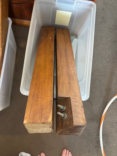

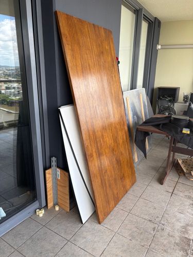

Hello, I have the same question but mine has grooves.
What grade of sanding paper should I use to remove the old varnish? I have a belt sander and an orbital sander.
Will it remove the colour? If so, should I get the stain and varnish in one?
Thanks!
Welcome to the Bunnings Workshop community @georgiana. It's brilliant to have you join us, and many thanks for your question about weatherproofing a table.180-grit should be enough to strip the varnish, but if it's particularly thick, you could drop down to 120. You'll need to finish off with 240-grit to remove any scratch marks from the previous sandpaper. I'd recommend you try the orbital sander first to see how you go, as belt sanders can be a bit aggressive.
It's likely that the colour is in the current coating, so I would advise using a coloured varnish or stain it to the desired colour separately.Please let me know if you have any questions.Mitchell
That’s exceptionally good advice! Thank you very much. I’ll order some sandpaper for my belt sander now!
