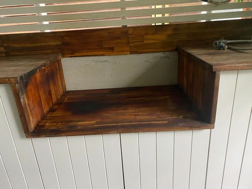

I have a built in bbq recess on an outdoor bench
i bought a replacement bbq however it doesn’t fit I need to reduce the width of each the two timber vertical sides by 15mm. The vertical sides are 280mm in height
Is there a suitable tool I can use to cut this depth or is it simpler to remove and replace ( if possible) the sides to fit What would be recommended for heat resistance Appreciate your advice

Could I please confirm, is the new BBQ 30mm wider than the current opening, and you're looking to move the vertical pieces out 15mm on each side? If not, could you draw a diagram or provide a little more information on what you'd like to achieve?
I'd certainly recommend you provide more clearance than what was there was previously. The timber on the bottom looks particularly scorched and likely wasn't far off a fire at some stage. Fibre cement sheeting would provide more heat resistance than timber, but it's also essential to have an air gap. It would be my advice to remove the entire combustible timber recess and replace it with one made from James Hardie 2400 x 1200 x 15mm 2.88m² HardiePanel Flooring.
