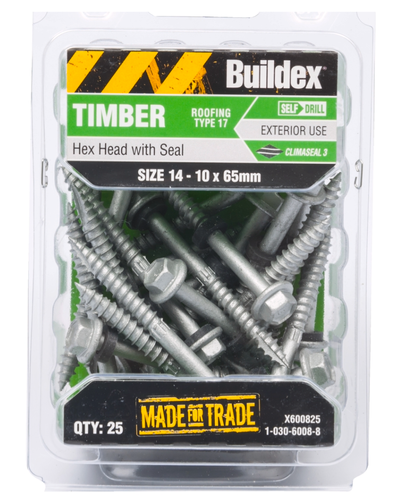

Hi, I'm looking at doing something similar on our new home that has Hebel.
I need to fix a CCTV Wall Bracket.
Did you end up using plugs?
I was looking at using these screws without plugs.
Hi @Damir,
Thank you for your post and welcome to the Bunnings Workshop community, it is fantastic to have you with us.
Allow me to tag @GVO so they are notified of your question.
If you choose to use these screws without a plug, I'd encourage you to read and understand all the details relating to your specific application in the Fixing to Hebel Guide.
