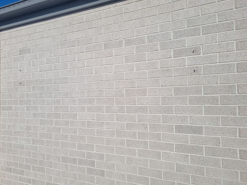

Hello I recently have had a man attempt to mount my fold down clotheline to new build brick house standard austral bricks using ramset ankerscrews 8mm (that i supplied) and it failed. I changed my clothesline and the bracket will take 6mm Max. I'm not sure if there is a way to utilise the exsisting holes from the 8mm ramset ankerscrew fail or if new holes will be needed and if so attempt to use 6mm ankerscrews - will be strong enough and why did fail first time.

Wow to those anchor screws failing. I have used them a few times and havnt had an issue (Tho I did not drill the original holes deep enough or remove the concrete dust the first time lol so I had issues) Its always a pain when things dont go as expected. Also I would like to say welcome to the community :smile: Its a great place for ideas and how to solve problems.
Do you know the size of the holes that were drilled originally? (I am asking just to see if its worth using the same type of screw again) The only way I can see those screws failing would be the hole being too big to start with so the thread dosnt grip properly.
If you dont want more holes in your wall you could potentially use the existing holes to mount some timber battons and screw the new clothesline to the battens, Tho that depends on the width being the same as the existing holes.
I have used these guys before sleeve anchors and they work well. If I had to choose between the two types Id go the wall ankerscrew tho.
One last question, can you tell us how it failed? As in do the bolts pull out of the wall/are loose type deal?

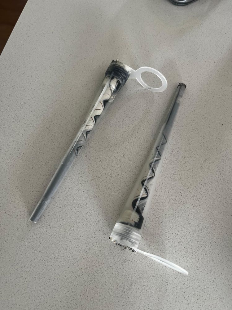

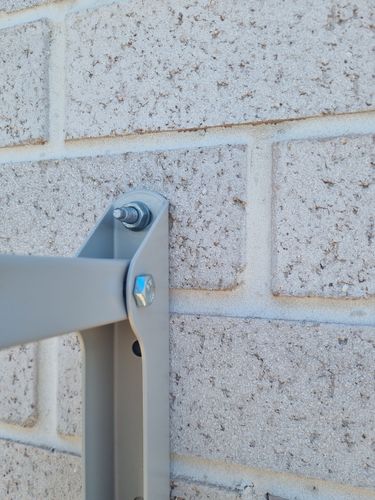

Hello everyone.... I got the job done using the ramset ultra fix, multi sieves and rods....

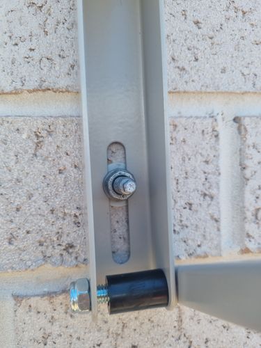

If you have time I and some spare washers I would put a washer under those nuts that secure the clothesline to the wall. They will hold the way they are but a washer will distrubuite the weight eveningly especialluy on blanket washing day.

I've placed plastic ones , I will swap out for galvanised one day soon! 😃  Clothesline goals!!!! Whoohoo

Thank you so much for the update! It's good to see that the anchor studs fit into the mounting holes of the clothesline. I totally agree @Dave-1 it isn't every day that you celebrate a successful clothesline mounting. But this one is going into my bookmarks as it is a perfect example of mounting a clothesline with a Chemset system.
