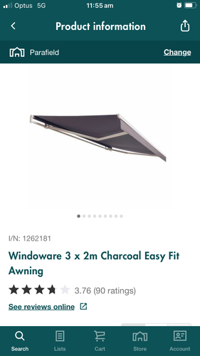

am looking at purchasing Windoware retractable awning and would need to mount it to colourbond fascia. I have three rafters/trusses? with the fascia clips in the area I would like to mount it. Can I put a block of timber between the end of each rafters and the metal fascia to bridge the gap and then mount a timber fascia board on the outside of the existing metal fascia, screwing through to the ends of the timber trusses. I would then mount the blind to the new timber fascia board.
would this set up be strong enough to safely mount this blind?

Thanks Michell for prompt response. Given the brackets on the blinds have holes 100mm apart I would go with 190 x 35 h3. I assume this would work ok
