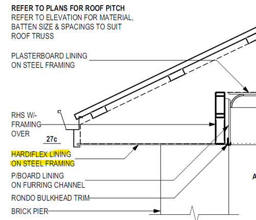

I'm hoping to get advice on how to mount security camera junction boxes to hardiflex eaves on steel framing for a recently built house. Below is from the plan for my house:

The two things I'm unsure about are:
Thanks!

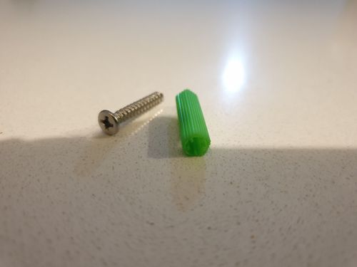

Hi @goteDeath The screw and screw plug in picture is suggesting a masionary fitting. the screw alone is timber and or metal bracket,

Hi @Jewelleryrescue, thanks for your quick response.
If the supplied screws aren't suitable for hardiflex lining, can you please advise what I should use instead?

That hardiflex is a pain to screw at the best of times. That screw should drill into it but it is hard to start the screw into it especially up high at arms reach. What may help a lot is pre drilling the holes with a drill bit smaller 1/2 diameter of the screw. You may break or blunt the drill bit as that is what hardiflex does. If hardiflex gets damaged you can always put a piece of square ply and glue it liquid nails on the inside of the hardiflex ( or you can glue it on to the outside and paint it ) so the screw can attach into the ply (5mm -to 19m as a guide) put hole in ply for cable too. The ply will also support a bigger camera size and weight in case one of them is a turret type

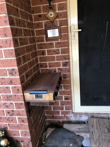

I also mounted a cameras at knee height hidden it a parcel shelf so Those fools in hoodies looking eyes down will give a good
mug shot lolSneeky cam for hooded morons
I will silver film the perspex this was a test re IR glare which was zero as I turn IR off
I used Poe internet cable and I was to lazy to by RJ45 crimp tool so i used premade Cat 6a cables so that meant larger holes to fit whole RJ45 connectoers through 14mm dia

While @Jewelleryrescue has given you some really good advice, don't use the fittings they give with the cameras.
Hardiflex is one of the most useless things for screwing into.
