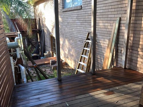

I have read the same thing, especially with exterior paint. For the paint I got up at 6am and started. For the oiling of the deck Ive actually been doing it from 4:00pm onwards usually tho have started early one day (12:30pm) as I had things I wanted done. Ended up paying for the miday oiling the next day with heat headaches lol
So Id go with 4pm onwards, prep the area before hand. Even if you break the deck into smaller sections and do part per day it can work. When I do this I oil up to a straight line of timber.
I ran out of oil this afternoon but the line shows you how I finished for the day, It lessons teh chance of any discrepancy you may have.
