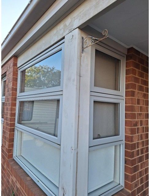

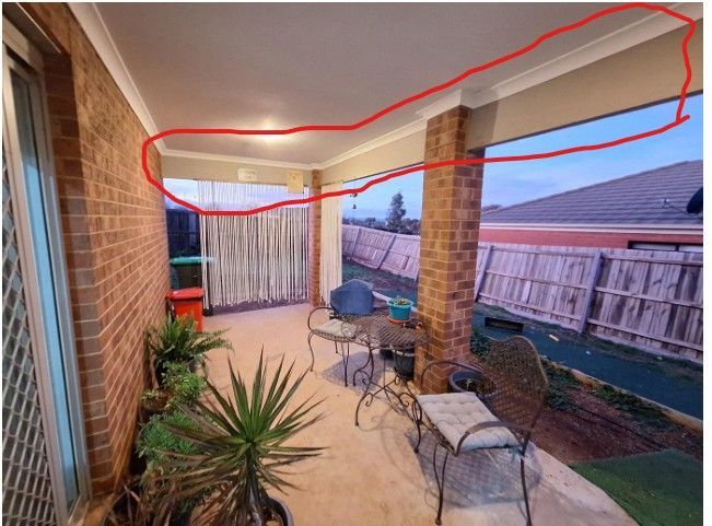

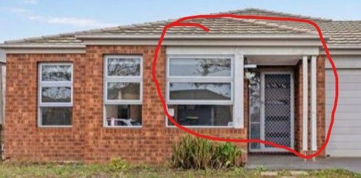

Hi i was quoted about $1500 to have this wood located at the front of the house and rear alfresco area painted again to protect against weathering. It was recommended by my building and pest inspector to have it re painted again to protect it as it will be our new rental in about 3 weeks time and its something we dont want to hold off as we were told the cost to replace the wood would be expensive. How would i go about painting this ive tried google and everything is weatherboard specific when searching "how to paint external house wood" ect ect. What is this type of construction even called, its technically not a window frame or cladding? Just looking for advice on how to best paint this as surely its not a $1500 job. I was thinking with money saved by DIY i could purchse some dulux weather shield, some nice brushes a new ryobi orbital sander and some frog tape? .  Ive had to work off pics from the building inspector and real estate site as i dont have access to the property just yet.. Many thanks in advance for you help glad to be a new memeber of the community.

Your proposal of purchasing Dulux Weather Shield, some nice brushes a new Ryobi orbital sander along with some frog tape is an excellent idea. Sanding the surface would be the first order of business, I would also add Parfix 500g Ready To Use Multipurpose Filler - 500g to your shopping list to fill in any cracks, splits and dents in the timber.
Once the surface has been sanded, I suggest cleaning the surface with a clean damp cloth to remove all the sanding dust on the surface. When the surface has dried off you can then mask the areas you don't want over painted. When the mask is set, you can then begin painting the timber supports. My best advice is to put signs on the brick posts indicating which one you've painted and what time you started. This will give you an approximate guide when you should put on the second coat.
