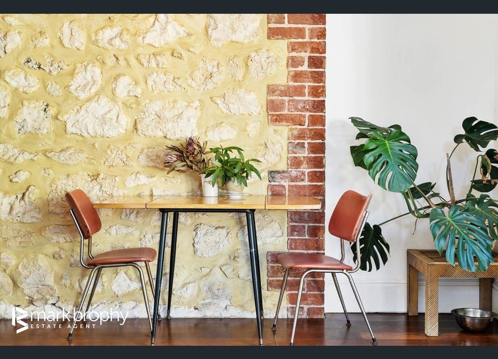

I have a similar question. Wishing to seal and paint these walls to stop dust and obtain a standard colour on the wall.

Is this wall in a partially covered area or is it inside the house? If it is inside the house, then painting it should not be an issue as it will be protected from the elements. Please just keep in mind that once you paint the surface totally removing the paint from the limestone surface will not be possible. In regards to the dust, even though the surface will be painted, the extruded parts of the wall will still catch dust.
It is fully internal kitchen walls. Thanks for your thoughts. Mike
Thanks again EricL. Just to clarify about dust. Will painting help stop the wall disintegrating. It can shed dust and bits more than it actually 'collects' dust.
Small bits come off now and then around the base, if sweeping or chair knocks the wall. Thanks, Mike

Paint will help to seal the limestone and keep the dust from flaking off, but if it is structurally compromised, then it is not going to fix that. You'll have to use your judgment, as I can't assess the wall for you.
I'd suggest giving the wall a good cleaning with a stiff-bristled brush to remove as much dust as possible and to remove any sections that are breaking off. If you can get the wall to a point where the surface is stable and sections are no longer coming off, then you should be fine to proceed with painting.
If the wall continues to flake off and degrade, then you may need to look at replacing or covering it with an alternative cladding.
