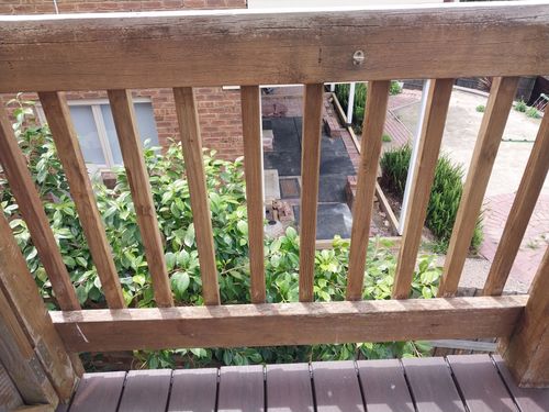

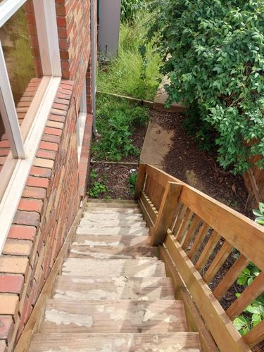

Stairs.. all cleaned and filled and sanded.

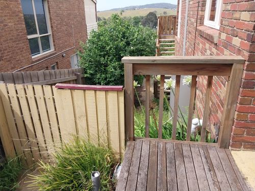

Little decking strip with rails and gate that was painted by previous owners..
I know regarding the gate I need to strip the old paint.. not worried about it right now. Want to do the decking strip and rail that's on the right now
As you can see its all very weathered.. it wasn't  looked after properly in the past.
We want to paint the rails a combination of white and charcoal grey to match the theme of the house.

Re: How to paint my outdoor timber deck area?
Hello @nishtha
It's important that all the old stain and sealers be sanded off to prevent staining. But if you are going to paint the rails in solid colours, I suggest using Zinsser 3.78L Bulls Eye Primer Undercoat Sealer And Stain Blocker. It seals stains, graffiti and tannin bleed. It can be used for interior or exterior applications. It's formulated to prevent tannin and stain bleed which often happens when using ordinary primer on stained timber.
If you are worried about the primer being too bright you can have it tinted to a grey colour.
In regards to the topcoat, I suggest having a look at Dulux Weathersheild or Taubmans Sunproof. Both of these brands have all the things you are looking for. It is self-priming has UV protection and helps resist mould, dirt and stains.
