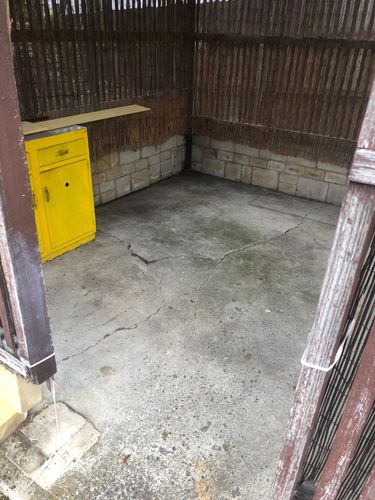

I'm wanting to built a 3x3 prefabricated shed on an existing concrete slab. The slab is much larger than required for the shed (approximately 4.2x3.4) so I'm worried about potential flooding.

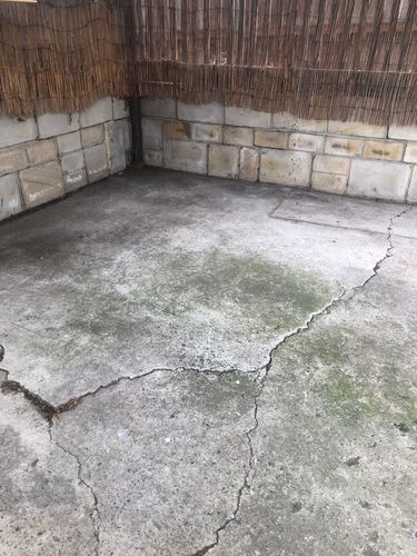

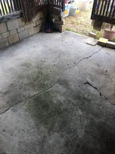

The slab is not level due to a a series of cracks - likely caused by a tree root - and so I'm wondering what my options are.
I figure pouring a rebate will be an expensive and time-consuming project that, given I'm not rectifying the cause of the crack in the current slab, may degrade quickly.
I'm interested in fixing the shed to the existing slab and building a floor as per @MitchellMc guide how to install a shed floor.
However, I want to ensure the part of the slab the shed sits on is level. Could I build up a 3x3 form and pour self-leveling compound to achieve this as suggested in @MitchellMc post how to level a cracked outdoor slab?
