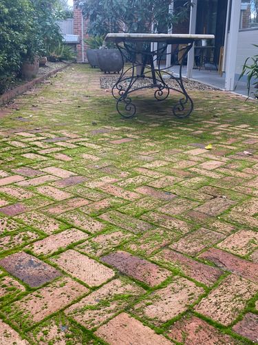

My red brick pavers have moss that is so bad. We have used regular bleach, power washing and other products to remove the moss but it is just temporary. It just comes back in 3 months. I want something to eliminate the moss forever preferably - I’m thinking of sealing it or any other ideas welcome.IMG_7163.jpeg

But Mitchell if you look at my photo - the moss is particularly prominent in the joints between the bricks. If I seal the bricks and then put paving locking sand wouldn’t the moss grow on the paving locking sand?

Unfortunately, sealing sand of any kind would not be effective due to its granular nature and the slight movement that these joints experience. A sealer would not be able to bond well to the sand, and even if it did, the slight movements would cause it to crack and fail quite quickly. Sealing the joints would also cause water to pool, which is not a great idea if you are looking to prevent moss growth, as moss thrives in moist environments. The unfortunate truth is that the joints between your pavers are always going to be a bit of a weakness in terms of moss's ability to grow.
When activated with water, polymeric paving sand (also called paver locking sand) hardens due to its polymer additives. This forms a more stable surface that makes it harder for moss to establish, ants to tunnel, and weeds to push through. While it won’t make the area completely moss-proof, it offers much better protection than regular sand, though occasional maintenance will still be necessary.
