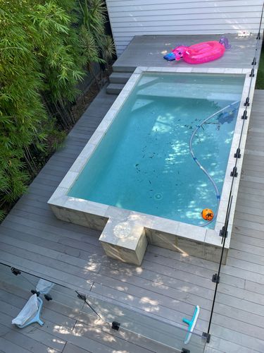

Thanks Eric! It's more kids jumping in the pool and splashing water over the sides this time of year rather than condensation, and being in SE QLD with the current humidity it takes a long time for it to fully dry out before it gets wet again. The main pain point is the time it takes to pressure wash the whole deck every couple of months, but pouring over the concentrate you mentioned every 6 weeks would be more doable! I have attached a photo for reference. Thank you!IMG_3072.JPG

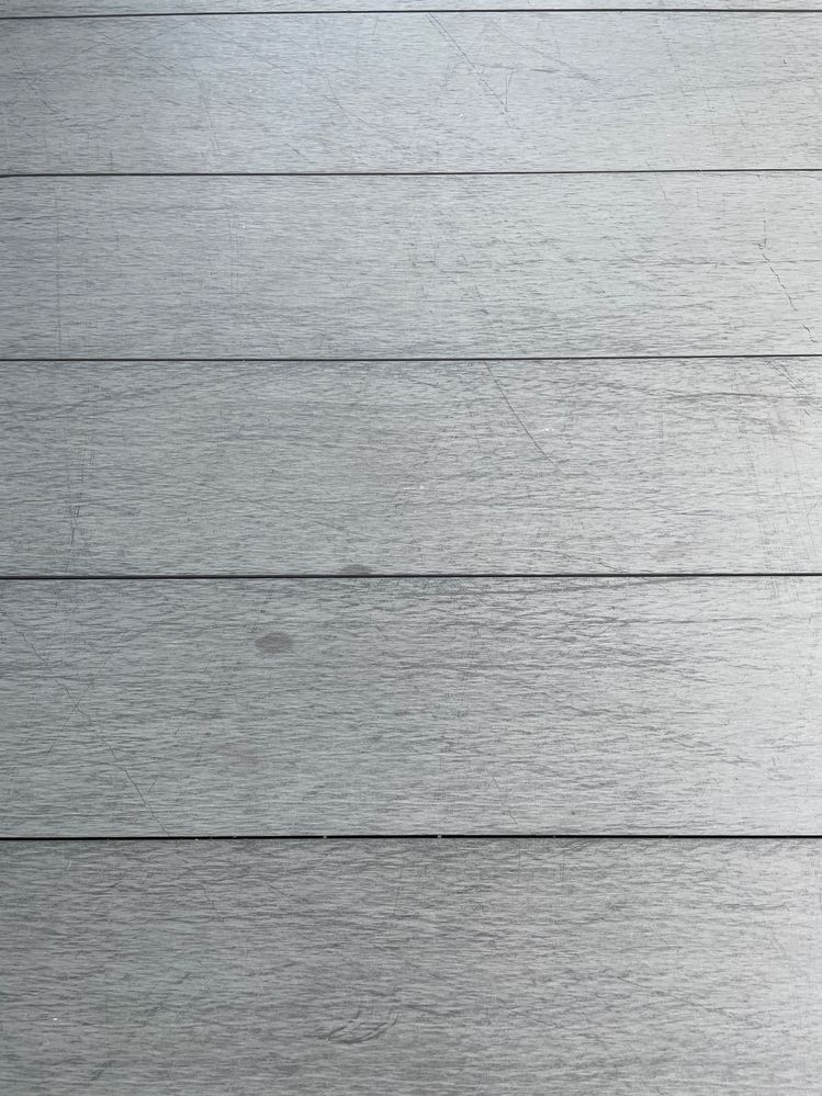

I have attached a photo for reference. The previous photo is a patch of deck away from the pool that doesn't have mould on it.

Thanks for sharing the photo! That pool area looks wonderful. I can now understand why you are getting mould growth every 3 months especially if the kids are in the pool every day. I still recommend using 30 Seconds 5L Spray And Walk Away Concentrate as it will help control the mould and mildew growth in the area.
