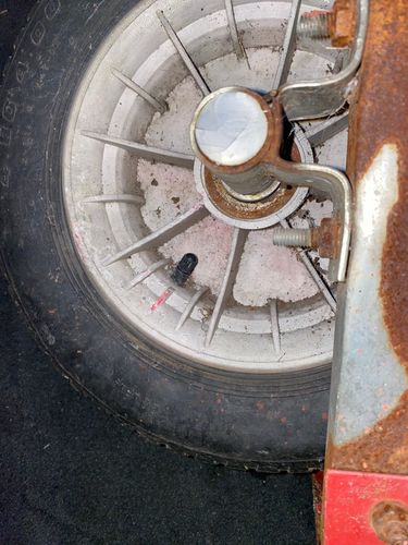

How do I access the valve to pump up the wheelbarrow tyre? It’s in a very tight spot. Thank you
Hi @Concrete1 , you can actually buy a 90 degree valve extension that screws onto the existing valve , most decent tyre shops should have them , or buy a tube with a 90 degree valve on it and change it over

Whether your pump has one or not, you should still be able to attach it to the valve. A common issue with deflated wheelbarrow innertubes is that when you try to attach an adaptor to the valve (as it is not supported) it gets pushed back inside the rim making the process difficult. If this is whats is causing an issue, pull the valve out as far as it will come with long-nosed pliers and hold the valve stem in position while attaching the pumps adaptor. You should also find the valve stem has a certain amount of flex to it and should allow you to bend it away from the tyre rim allowing your pump to clear the axel if needed.
