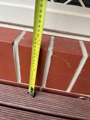

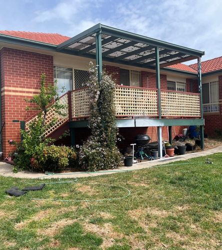

A. Can I raise it to match internal floor?

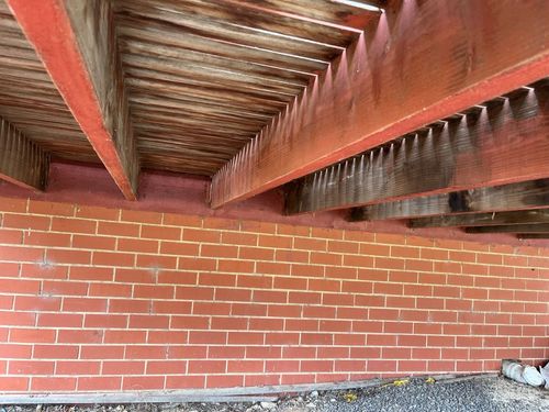

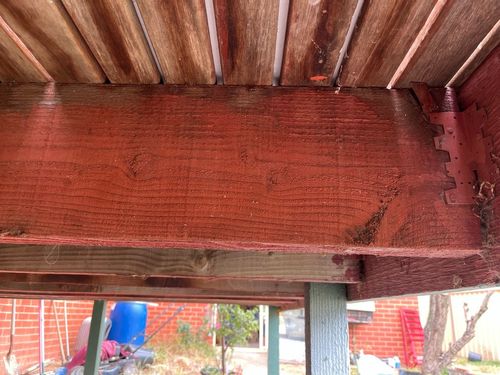

I think it would be possible to raise the height of the deck in line with the internal floor, but it wouldn't exactly be straightforward. The first thing I would be doing is speaking with my local council to see if there are any requirements for building approval. While it might seem pretty straightforward, as the deck is raised and tied into a roof structure, there can be engineering concerns when altering the structure. It is best to check and see before you move further into the planning stage.
I see three ways you could do it. Remove the old frame and start again, lift the old frame and reattach it higher up, or leave the frame where it is and attach timbers to the top of the existing frame. Each of these approaches has its own unique challenges and considerations that you would need to make.
Have you considered how you would move the frame up? Were you planning on lifting it or starting again with a new frame?

An interesting question, All the points that @JacobZ has raised are valid, One thing to keep in mind is your steps, Raising the existing height will cause the steps to be out of whack. To the point that any redo of the deck will need the steps to be redone as well.
Maybe do a few rough sketches of possible decks.
One a little higher but keeping the existing beams plus steps (it looks like you dont have a lot of space to extend an extra tread) as is, one raising the beams by the height you need and one redoing the deck itself and to allow for new stairs as well.
My plan was to add timbers to the top of the existing frame, but I’m guessing I’ll also have to add more support to the existing frame. And Dave raised a good point, I would have to redo the stairs as well. I’ll probably let this go for now.

Just to throw a more simplistic solution out there, would you consider just a floor level landing the width of the door and out say 1200mm. The entire deck wont be flush, but will provide an easier transition of heights when it not a doorway step. No permit required and very cheap to construct.
Nailbag
Thanks @Nailbag .. this is a great idea! I'll probably do that.. Thanks for sharing..
