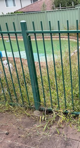

I am in the process of improving the usability of my back yard and decided to install a Deck. I am planning to stretch the decking all the way to the pool fence. This is going to raise the ground level and thus need to increase the height of the fence proportional to the increase in deck height. I am inspired by the low level DIY decks in this forum and decided to go with, the deck will be between 300-400mm above ground level. Would like some suggestions to increase the fence height. I have limited budget, so removing and installing a new  fence will be out of my budget, appreciate any suggestions or help.

@Jason  The pool fence and the non-climbable zone is in compliance with the rules. The current fence meets the pool requirements of 1.2m. When I install the low deck, it would be raising the ground level to 20-40 cm, this means I need to raise the fence by 20-40 cm.

Technically you would be extending the posts 20 to 40cm in height. I'm afraid the adjustment is too big and the gap underneath the fence would be a point of contention. In theory it would be covered by the low-level deck and not allow children to squeeze through, but the inspector might say otherwise and say that it needs to be a full fence that goes all the way to the bottom. I can only suggest either getting a new fence (which is outside the budget) or making the low-level deck bigger and transfer the pool fence onto the deck.

If you had a timber fence that would be the perfect solution. But because it is steel there is no simple way of joining to it.

Have you considered to simply replace just the existing pool fence posts with new ones installed on top of the new deck? This means you will be able to re-purpose the existing balustrade sections and screw them to the new posts fixed to the deck. This would be a very cost effective solution.
Bunnings have a range of pool fence posts on range. And if you google fence pool fence posts, you find a lot more. Unless I have missed something, I think this should resolve the key points of pool fence regulations that both @Jason and @EricL highlighted.
