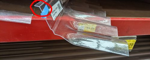

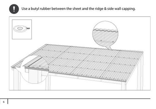

I do have a couple more questions regarding flashing if it's okay. I'll be using the Suntuf wall flashing for the high end-wall.
1) Regarding the top edge of the flashing: The profile of the flashing (see photo below) has a little turn-back at the top which leaves me a bit confused re how to attach it to a flat sheeted wall. How do I deal with the turn back bit (circled in the photo)?? I'm thinking that I'd cut that turn back off, then put a bead of sealant (or maybe a strip of Butyl tape would be better??) between the flashing and the wall, and screw the flashing to the wall (where there are studs). Do you have advice about that?
2) Regarding the bottom (ie the corrugated) edge of the wall flashing: I was assuming that I should NOT put any silicone sealant or butyl tape between this edge and the roofing sheets themselves, because it'd cause issues with the polycarbonate sheet's tendency to expand and contract with the heat That's a point that gets stressed in a number of documents about installing Suntuf (ie don't use silicon sealant due to expansion issues). However on one guide for  installing Suntuf roofing, butyl tape is recommended for use with the wall flashing (see photo below)?!?! Can you advise me on this please?
