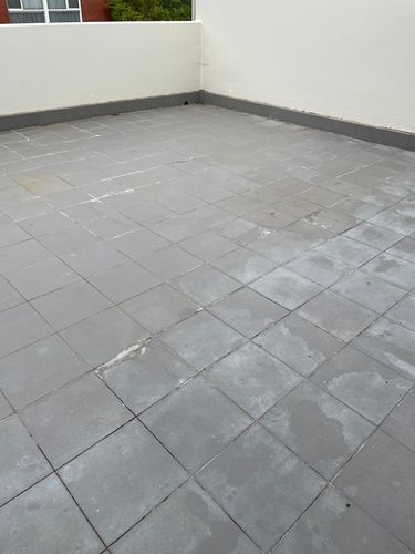

Hello,

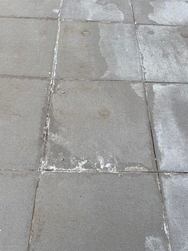

looking for some advice on my balcony tiles. I have a large balcony (approx 6x6m) that’s in need of a refresh. The grout is loose and wanting to remove the old grout and re-grout. Is this something I should be DIYing?
If so, any advice on what type of grout? It’s fully exposed to the elements. Main concern here is keeping water from seeping through  the level below.

Welcome to the Bunnings Workshop community @Hankonos. It's wonderful to have you join us, and many thanks for your question about restoring balcony tiles.
Is there currently an issue with a leak to the area below? When a balcony is constructed, a waterproofing layer is placed over the concrete balcony. The tiles are then placed over that. Any water seeping through the tiles is then captured and diverted to the balcony's drainage point, typically a hole in the exterior wall.
The grouting does look degraded, and it would certainly be worth restoring it, if even from an aesthetical perspective. The process involves cutting out the existing grout and removing all the degraded material. Even with a multi-tool and diamond blade, this would be a huge task, so you might want to consider getting a few quotes on the work from a professional.
Any standard exterior grout can be used for this project.
