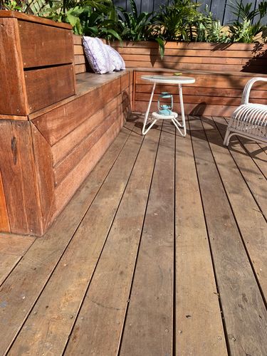

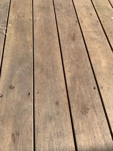

Hey everyone! Seeking some advice here. A couple of months back, I had my merbau decking set up in my backyard. I made sure to follow the recommended steps, letting the decking weather for a few weeks before applying Cabot’s Natural Decking Oil (applied it twice after proper preparation). But here's the thing, I'm not quite getting the vibrant natural merbau color I was aiming for. Instead, it's looking a bit grey and worn out, way older than it should. Is this par for the course or might I have missed something? I'd really appreciate your insights and any suggestions on what I could possibly do to rectify this. Thanks in advance.
