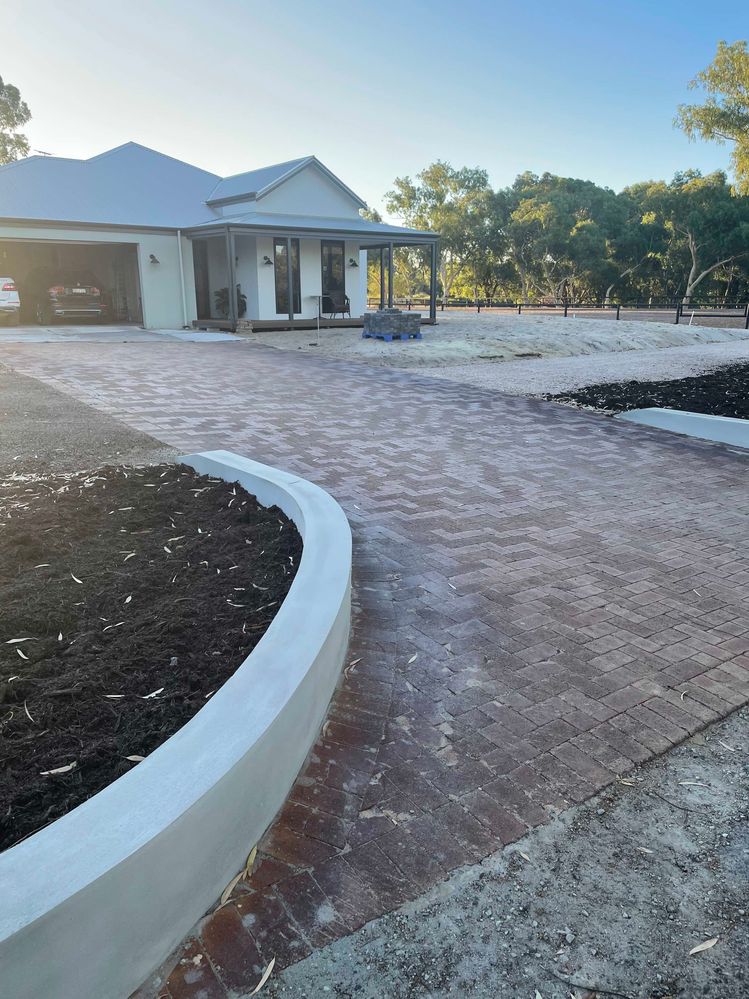

I have 120m2 of old paving that I am currently getting quotes on to either replace or rejuvente the pavers. So far, the less expensive option is Asphalt, but even that is around $10000. It is also quite stark. Looking for a softer rural finsih that doesnt bring stones or stain into the house. Would like to investigate sparying concrete onto the old pavers but njot sure how effective and long lasting that would be. Thank you

Also I actually like the look of your driveway as it is ![]()
Have you considerd pressure washing the pavers? They seem to be in decent condition and I mean still level and holding their form. (This is my number one suggestion btw
Have you lifted a paver or two to check what is under them? For a driveway of pavers not to sag or dip with time I am thinking that they probarly have been laid decently. Maybe even on a concrete base?
Spraying concrete over them would potentially crack with any movement of the pavers underneath later on. Maybe replace with larger square pavers to give it a modern but still keep that rural look? Or a mixture of both types of pavers? Would cost less but depending on how you do it could still work. Its one reason why I love pavers so much. You can keep reusing them ![]()

Could you please let us know the issue you're trying to resolve? Is there a problem with the current bricks or do you just not like the look of them? As mentioned, their appearance will be improved with a pressure wash, and then you could potentially seal them to prevent staining. They look to be in good condition and certainly provide a less stark look than asphalt.
I'd agree that any thin layer of concrete over the top will likely crack as bricks are conditioned to a non-rigid base, whereas the concrete coating would be rigid. This incompatibility leads to movement and cracking.
I'd recommend cleaning the bricks and then making a decision about whether you're happy with the result. You could either purchase a high-pressure cleaner with patio attachment or hire a unit for the day.
