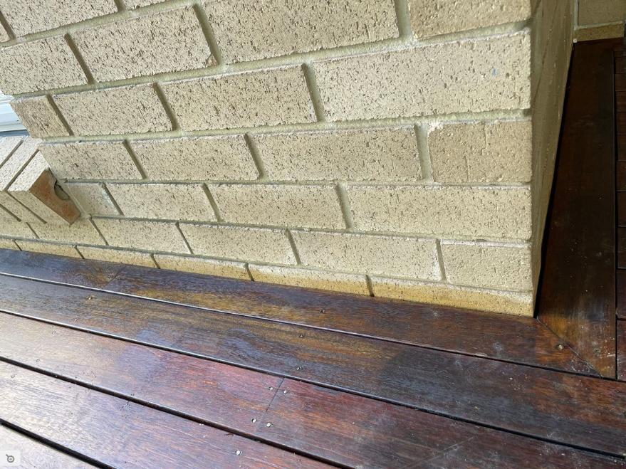

A couple of days ago I painted the deck with Cabot's Natural Decking Oil and some has got on to the house bricks.
How do I remove it?😕

Hi @LKF,
Since you're in such close proximity to the decking, if you use any strong chemicals, you're likely going to cause a bit of a mess. I'd suggest you try some warm water with dishwashing detergent and agitate the area with a stiff bristle scrubbing brush. Unfortunately, due to bricks being porous, they've likely sucked the stain and oil into their surface. If so, this might be a case of needing to wait until the stain fades.
Give the soapy water a shot and let us know if it was successful. If it's not, then we can look to other solutions.
