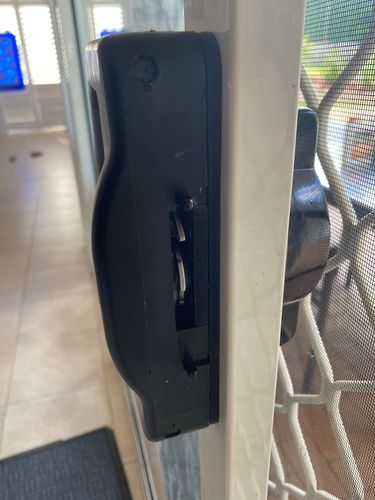

i cannot find the screws to remove the lock. Searched everywhere. See pics.
I try forxi

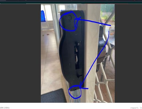

Your second picture shows two countersunk holes with black covers on them. I believe these are screw covers that are hiding the locking screws. In order to remove the black plugs, I propose trying this method. I suggest using a small flat head screwdriver with a sharp tip. Your objective is to lift the cover cap so that it reveals the locking screw underneath.
Once you manage to remove the cover caps you should be able to remove the screws that are holding the handle in place.

I tried, I even used a hammer to try to get through those 2 holes, nothing, it won't budge (didn't hit harder since it may all brake)
This is puzzling. Whoever designed this deserves a special place on this earth...
I propose engaging the services of a locksmith at this point in time. I'm afraid that it's time to call in the professionals to remove this lock for you. Any further force applied to it as you mentioned might damage the glass.

As mentioned, the screws are likely under the black caps. At this stage, the caps have been pushed in so far that it wouldn't be possible to pull them back out again with a screwdriver. Are they made of plastic? If so, you could potentially drill them out, being exceptionally careful not to damage the screw head underneath. Alternatively, which I'd try first, you could take a timber screw and drive it in through the cap. If the screw can be drilled into the cap, then it will give you something to hold onto and pull out the cap.
A word of warning, it's best to avoid using hammers around windows as the glass can shatter exceptionally easily. Whilst working around the glass, remember your PPE, including safety glasses, cut-resistant gloves, a long-sleeved shirt and trousers and enclosed footwear.
At this stage I'd be using a drillbit and using it to remove the black covers where the screws will be underneath.

It appears the caps have been pushed too far in @robv for the normal extraction methods to work. That could have been done by someone previously to you. I'm surprised there was no governor to stop them from being pushed in so far; perhaps it was done forcibly. When pushed in only so far as they are flush with the surface, a small flathead screwdriver can be placed in that little slot at the bottom, and you can flick the plug out.
excuse my ignorance.These caps I should try to push to find hopefully the screws behind them?
Hi @robv
That is the suspected location of the mounting screws for the handle. If you can get the caps off, the screw heads should become visible, and the handle should come off revealing more of the mounting screws inside. If anything, I suspect that the caps have been pushed in too far, I propose pulling them out so that you can see what's inside. It's the only possible point of mounting as there are no other location of screw points on the body of the lock.
