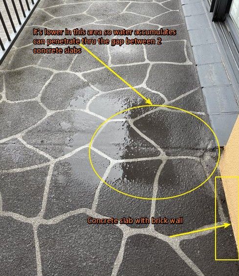

1. uncovered porch, needs some sort of water repellent sealant to extract water efficiently when it rains hard
Uncovered porch - water repellent sealant requiredUncovered porch - water repellent sealant required

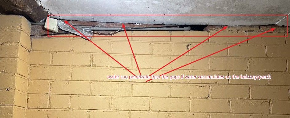

2. Water can go under / penetrate from above - the uncovered porch bits
Water can penetrate thru the gap (slab & brick wall)Water can penetrate thru the gap (slab & brick wall)

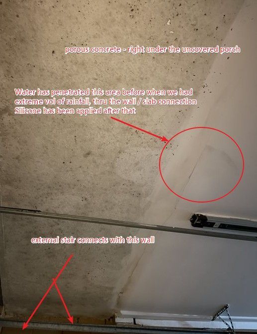

3. the porous concrete slab is right above the smaller garage, the front portion of the garage, water had penetrated via the gaps (slab with brick wall - it's been sealed with selley's storm water silicone or similar)
So I consider putting a layer of good waterproof / repellent coating may help to avoid the issue.
porous concrete right under uncovered porch bitsporous concrete right under uncovered porch bits

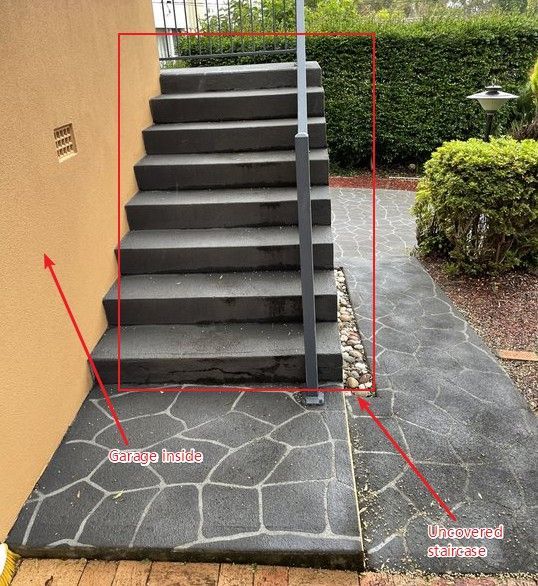

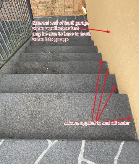

4. When doing it, I'd apply the same coating to the stair (not covered by roof) that connects to the exterior wall of the same garage to avoid water into the wall / garage.
uncovered stairuncovered stairstair view 2stair view 2

Before you apply a sealer, I suggest investigating all possible sources of leaks going to the garage. It would be a shame to seal this uncovered porch area only to discover that a small crack has been left unsealed. I suggest using Selleys 300g Clear Roof And Gutter Silicone Waterproof Sealant to plug up any cracks or holes that may allow water to flow down your garage wall.
Once everything has been plugged up, I recommend using Crommelin 4L Natural DiamondCoat Paving And Concrete Sealer. I suggest following the test procedure recommended at the back of the can before applying the sealant.
