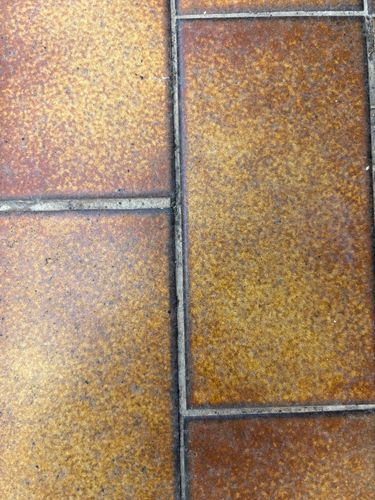

Hi everyone, the previous owners of our house painted the front (outdoor) verandah tile using Dulux Renovation Range Floor (interior) tile paint with satin finish.
How might I remove the paint from this type of outdoor tile? I would love to restore them to their former glory!
I've attached images of the front verandah where the paint is chipping, as well as some tiles that weren't painted.

I would sugget a high pressure water blaster and taking your time over it. The paint is lifting alrady so hopefully you can remove the rest. Keeping the glaze on the old school tiles is my main concern so I wouldnt be using a iwre brush or drill attachment.

As @Dave-1 mentioned, I'd recommend first blasting as much paint off as possible, and you want to stay away from anything abrasive. You could try some paint stripper on a small test area to see if that will easily lift the paint. Unfortunately, it will be a messy business, so please wear PPE, including a long-sleeved shirt and trousers, a facemask, eye protection, and rubber gloves.

Thank you for your suggestion, Dave! Have just given the pressure washer a try (wearing all appropriate PPE of course!) and it's working quite well. There's a few tiles where not all of the paint is lifting with the washer alone, so may try some paint stripper later on as Mitchell suggested.

With the paint stripper, maybe try it on an out of the way tile just in case first. Just to check if it wants to etech the surface )most prob wont) but err on the side of caution.
