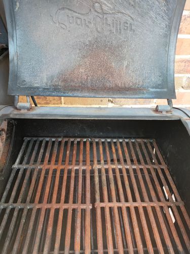

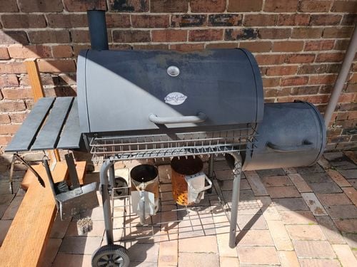

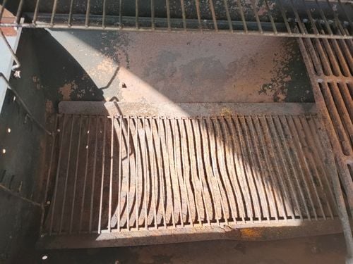

Hi
I got this free char-Griller Deluxe Charcoal BBQ together with its firebox.
There are rust inside and outside of the grill
Would like to know:
1. If its safe to use it as it is
2. Can I leave the interior rust of the grill and how to remove it?
3. How to remove the rust on the grates?
Appreciate any suggestions
Thanks
Thierry
Good score, @Thierry!
Using the grill is safe, but you'll end up with some fairly rusty steaks. At least you'll know that your iron intake is sorted. You can either try to clean the grills up or replace them. You'd likely be able to Special Order them, or we might have a replacement in stock. It would be best to take one of the grills with you to your local store to see if a helpful team member can match it up for you. It could quite possibly be this Char-Griller BBQ Spare Part Cast Iron Grill. For that price, I'd just be replacing them. Alternatively, run a wire brush over them until the rust is removed and re-season them with oil. To re-season, you need to get the grills scorching hot, brush on some oil, and let them cool. After doing this three times, they'll be seasoned. This layer prevents your food from sticking. Always coat your grill with oil in between uses, otherwise it will rust again.
Hi @MitchellMc
Thanks for the advice.
How about the internal and external rust, excluding the grates?
Do i need to do anything with them?
Thanks
Thierry

You don't need to do anything with the rust on the other surfaces @Thierry, as most of it is just aesthetical. You'll find the paint has most likely burnt off on those inside locations due to high heat. You could certainly spruce up the outside of the unit with Dulux 300g Duramax High Heat Black Enamel Spray Paint. Before spraying, give the outside a good scrub down with warm soapy water and a heavy-duty Scotch-Brite pad. The scouring pad will remove any powdery paint and prepare the surface.
You could paint the inside of the panels, but personally, I wouldn't. You risk it burning off and ruining a good bbq. The underside of the lid could be done if you like.

Hi @Thierry
It's not necessary to heat up the grill of the barbeque. I suggest using cooking oil and scrubbing the surface with a Sabco Professional Pot And Pan Scourer. I don't recommend using any harsh chemicals as this will contaminate the surface of your grill. Once the rust has been scrubbed off, I suggest rinsing it with hot water. Dry the surface with a paper towel and apply a coat of vegetable cooking oil on the surface to protect it from rusting. For very stubborn rust you can use sandpaper to remove deep-seated rust.
