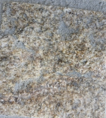

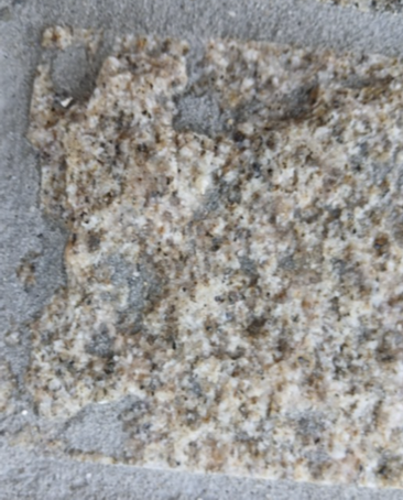

would you recommend this product to remove stubborn cement grout  Builders Edge 750ml Cement 'N' Concrete Remover ?
I say stubborn because I have already tried an acid based (phosphoric) product at 1:2 with no success
my concern with builders edge is that I dont want it to eat the grout, I only want to remove the grout on top of the cobble

Looking at the photos you posted, it appears that the grout has settled onto the crevices of the cobble surface and has acted like a filler to the uneven surface and since it is grout, it's also likely that it has attached itself to the porous surface of the cobble. The Builders Edge 750ml Cement 'N' Concrete Remover might work, but I've only seen this applied on flat surfaces where the cement has accidentally settled on tiled or paved surfaces.
I propose testing a small area away from direct view and see if the cement remover will work on the surface of the cobble. I also suggest tyring to use a flathead screwdriver to manually remove the grout that has settled on the cobbles surface.

I would be inclined to use the narrow wire brush gently across the top and into the crevices should the chemical treatment @EricL fail to work.

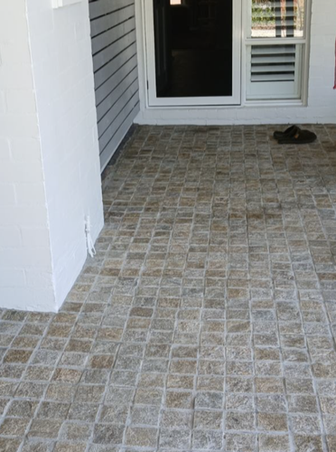

at approx 300 cobbles that require cleaning I have a long term project ahead

thanks for the wire brush tip Nailbag, as long as there is no scratching it could be very handy

the wire drill brush turned out to be the perfect solution, I cleaned 12 sq.m of cement covered cobbles in about 4hrs
prior to this I had spent a week unsuccessfully scrubbing them with acid; builders edge was a little better, but not much better.
problem solved, thanks Nailbag 👍
