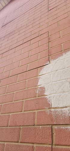

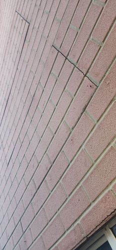

The house was clad 50 years ago with these cement sheet fake bricks.... Generally speaking the boards are attached to the weatherboard house well - occassional little loose board here and there, but realistically it has held up well and it still is structurally good. Its just an eye sore - as all the 'grouting' of the boards which were caulked are cracking from years of movement.
I really do not want to remove and replace the cladding - thats a huge cost. Yes its asbestos backed boards - which are safe as they are not broken up...

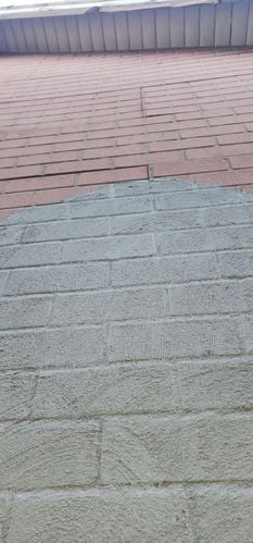

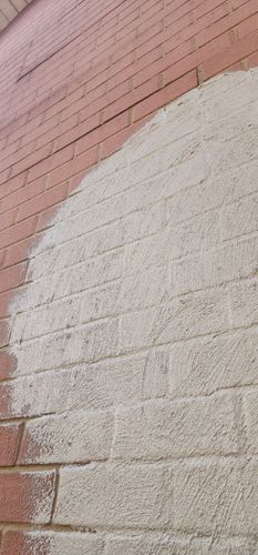

So I thought lets try the Dulux texture paint... First attempt at rendering - using a glove... and I am pretty happy with the result.
The above pictures shows a before and after... The render really does hide the 'panel' look.

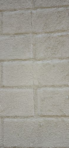

Although - the following day - I can see fine hairline cracks. Only visible when you stand right in front of it - from the street it looks perfect.
Given how it was - it is much better!... Sure a second coat might fix this... But dulex texture is expensive (all paint is these days).
Thinking I will use Sellys external no more gaps and a finger to try and fill cracks a little more before applying the paint.
