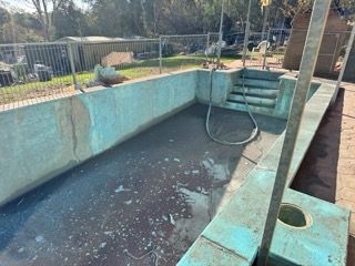

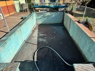

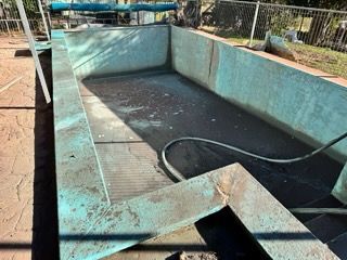

Hi everyone,
I’m hoping to get some advice on the best way to fix my pool.
We moved into our home about 20 years ago, and I was told the pool is made of Besser blocks with concrete and some fiberglass patches, which were then painted over.
Unfortunately, it hasn’t been repainted in a long time, and when I recently drained it to prep for either - repainting, adding a vinyl liner, or tiling, I discovered a large crack at the bottom.
I plan to do a lot of the prep work myself—sandblasting the sides, grinding if needed, and making sure everything is smooth and ready.
As a single mum on a mortgage with a limited budget, I’d love to hear your recommendations on the best, most cost-effective way to repair the pool,
so, it looks good and stays functional. Any advice would be greatly appreciated!
Thanks in advance!

It's good to hear that you are ready to tackle all the prep-work that's required to get your pool functional again. If there is one part where I suggest spending money on, it is on the repair of the crack in the pool. I recommend engaging the services of a professional pool restoration specialist, they should be able to determine if the foundation of the pool has been compromised or if the crack at the bottom can simply be sealed. Spending your budget on the best possible seal you can find means that you' won't have to worry about water draining out for years.

I would definently spend a chunk of money and get the crack and base structure checked by a pool professional (one with abn and has references you can look at) They will also be able to tell you the things that you can do and shouldnt do repair wise. I had a mate who had his fibreglass pool surface repaired and it was a headache. I have a fibreglass pool that is old and probarly needs resurfacing and has cracks on the coping but its still going ok. Its on my list of things to repair one day.
Your pool walls look in resonable condition tho the concrete fill on the steps will need to be sealed, I would talk to the person you get to investigate that crack for suggestions on handling that.

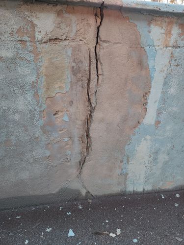

Hi guys so I am still going. Have had pool sandblasted not quite finished and have found some doozie  cracks under fibreglass. So plan is to fill and then paint whole pool with few coats of epoxy pool paint. Thoughts? Ideas for cracks

That crack is pretty large, does it line up with the crack on the bottom of the pool or with a crack on the oppisite side? I have concerns that structually it may have issues and would be at the point of getting an engineer to have a look/survey to make sure you arnt starring in the "Money pit" (Great Movie but you get the drift)
I have not used an "epoxy pool paint" before but even with a few coats I am still concerned that crack will continue to open up, I would be thinking of stabilising the structure first (making sure the side of the pool isnt sinking either end therefore opening up the crack) So would strongly suggest to get a proffesional to have a look.

I definitely agree with @Dave-1 in his assessment. I strongly suggest having a pool specialist come over and have a look at those concrete fissures to make sure that your pool is still viable.
