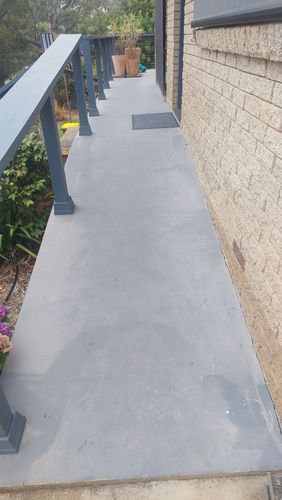

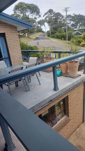

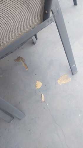

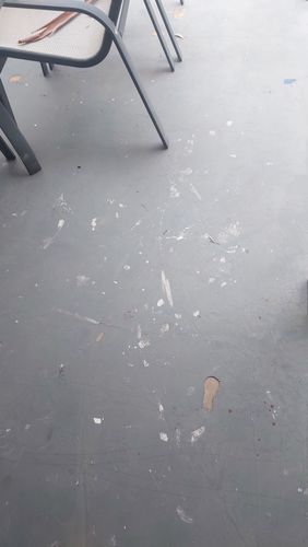

Hi, im looking to repaint/renovate my large concrete deck (approx 55sqm) and am open to suggestions of ideas, products and applications. The deck was painted professionally 7ish years ago however has began to show age with cracks and paint from renovations, and  mainly always looks dusty/dirty. (Overall in good condition, photos attached of damage).
With no expasion gaps across the deck, there are multiple hairline cracks (5 or so), and would most likely appear no matter the finished product?, in this case, I'm interested in a product with texture or depth (not flat) to help hide this.
I've got the tools and the relevant experience to handle the project so am open to ideas!
Thankyou!!

I would recommend starting by removing all loose, flaking or damaged paint to make sure your new finish adheres properly. A paint scraper and a stiff bristle broom usually do the job, though a light sand can help feather out any raised edges. Once the loose material is cleared, give the entire surface a thorough clean to remove dust, dirt and any contaminants. A concrete cleaner or sugar soap works well, followed by a good rinse and time to dry.
For the cracks and worn areas, a cement-based patching compound such as Earl's 1kg Concremate Expanding Cement is ideal. It allows you to fill hairline cracks and small depressions so the surface is even before coating. After patching, you can lightly sand the repaired spots and then prep the whole deck according to the requirements of the coating you intend to use.
Regarding whether the existing paint needs to be fully stripped, that usually depends on how well the remaining coating is bonded. If most of the paint is still sound and only small sections are failing, you can generally clean, patch and then prime the surface before applying your new finish. Full stripping is only necessary if the old paint is peeling extensively, chalking heavily, or lifting in large sheets. From the photos, the coating looks mostly intact, so a full strip may not be required.
I understand that you are after a coating that has texture or depth to hide any cracks or damages your floor might have.  But if you were diligent with your repairs, none of the damages will be visible as you've covered them up with Earls cement patch. It is possible to add anti slip additives to the White Knight White Heavy Duty Ultra Pave Concrete And Paving Paint - 4L in order to give it a less flat look and provide grip when you walk on it. There is also the Rust-Oleum 3.78L Battleship Grey Concrete And Garage Floor Paint along with Berger Jet Dry 4L Deep Charcoal Heavy Duty Paving Paint
Here is a handy step-by-step guide: Ultra Pave - HOW TO
