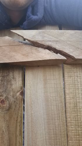

That appears to be one of the rails that has snapped. If there is no apparent reason why the rail has broken, then it's likely there was a compromised section of timber in it that has fractured. You'd be looking at removing all the pailings for that section of fence and replacing the rail. Once you've removed the pailings, you can pick up this step-by-step guide at the Installing rails and plinths for a pailing fence step.
It doesn't look like a particularly old fence, was it installed recently? If this is a new fence, I recommend speaking with the installer about this issue.
