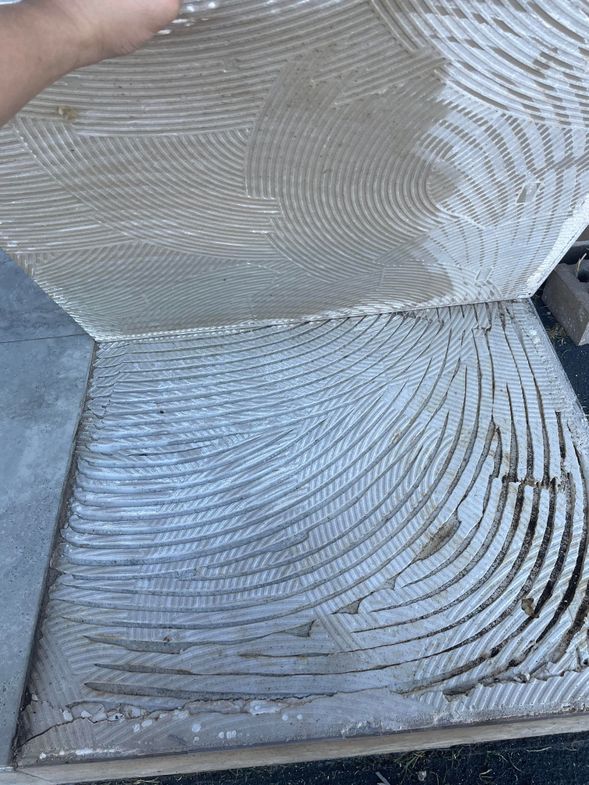

I have a loose/hollow floor tile that can be lifted up just outside my front door. Any tips on how to repair this with minimal effort?
From what I can find online, my options are:
1) Find some sort of glue adhesive and spread it in-between the grooves; or
2) A more involved way would be to try to chisel off the grooves and add a cement based adhesive?
Any further advice would be very much appreciated.

I was just looking up how to remove tile adheasive... And I keep coming back to my first thought. A cold chisel and hammer. And work slowly. You could also use a concrete grinding disc . Concrete masonry discs to show you a range of them.
I would leave the tile as is and not try to remove the glue as I wouldnt want to crack the tile. (Unless you have spares?)
Once you have cleaned it back to the point that you think enough of the glue will be spread eveningly and sit flush with the other tiles use a product like dunlop 2kg wall and floor tile adhesive (You can prob find a smaller quantity

Many thanks @Dave-1 for the advice!
Will try and remove the glue that is on the ground but will leave the glue on the tile as is and see how we go.

It's great that you've received excellent advice from @Dave-1. His recommendations are spot on, I would only suggest having a look at the Dunlop 1kg Premixed Resaflex Tile Adhesive if you are looking for a smaller quantity of tile adhesive. In regards to grouting, I suggest looking at Dunlop Ready-To-Go grout.
