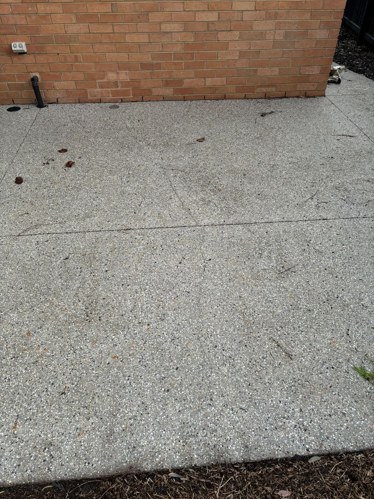

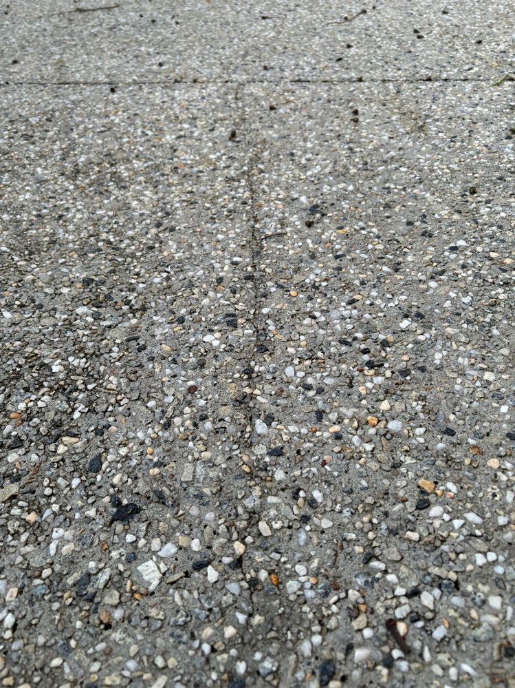

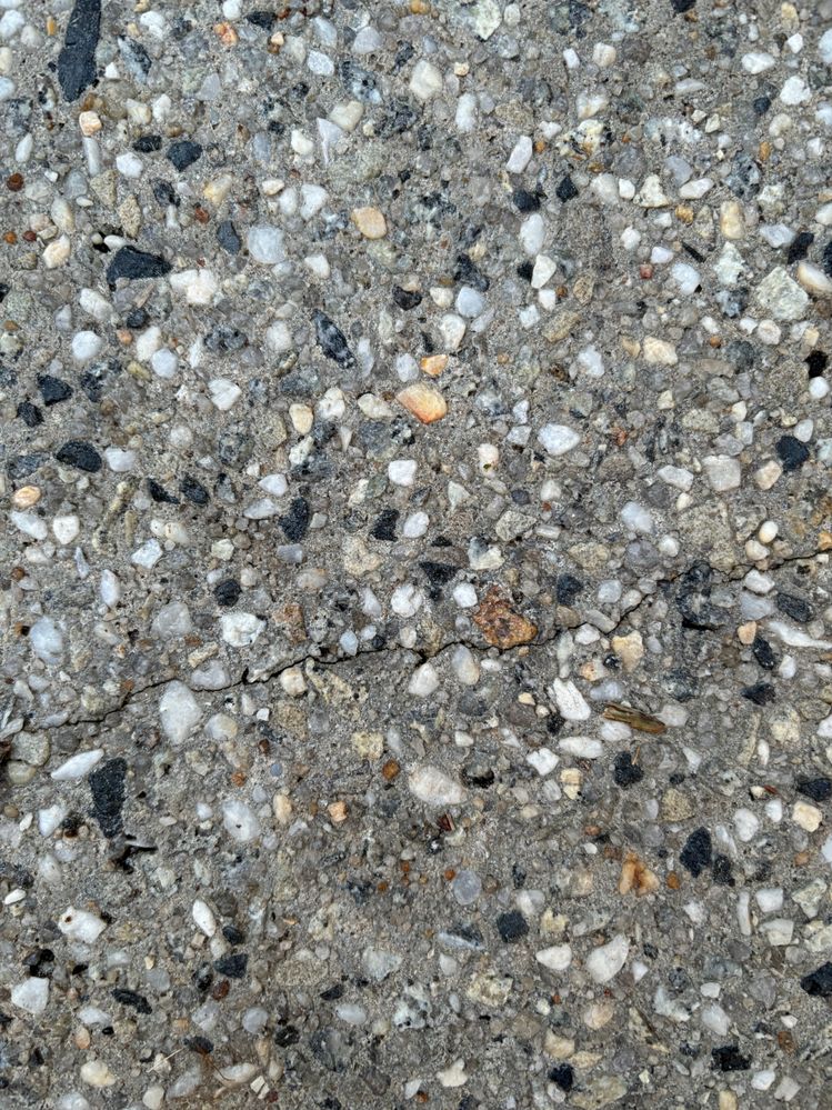

IMG_2431.JPGIMG_2432.JPGIMG_2434.JPGIMG_2435.JPGHi,
May I ask how do I fix a long hair line crack on my exposed aggregate in  my backyard?
thank you
Lawrence
Re: How to repair crack on exposed aggregate path?
Hello @lawrenceoh
Welcome to the Bunnings Workshop community. It's sensational to have you join us, and thanks for sharing your question about your aggregate path.
Because the crack is very fine, I suggest using Selleys 415g Brick And Concrete Sealant. Before sealing it, I propose cleaning the crack with water and detergent making sure to remove all loose debris. Once the surface is dry, I recommend cutting a small outlet on the nozzle so that it produces a fine bead.
I propose using a disposable glove and pushing the sealant into the crack. Please note that the sealant is grey in colour and might stand out on the surface of your path.
