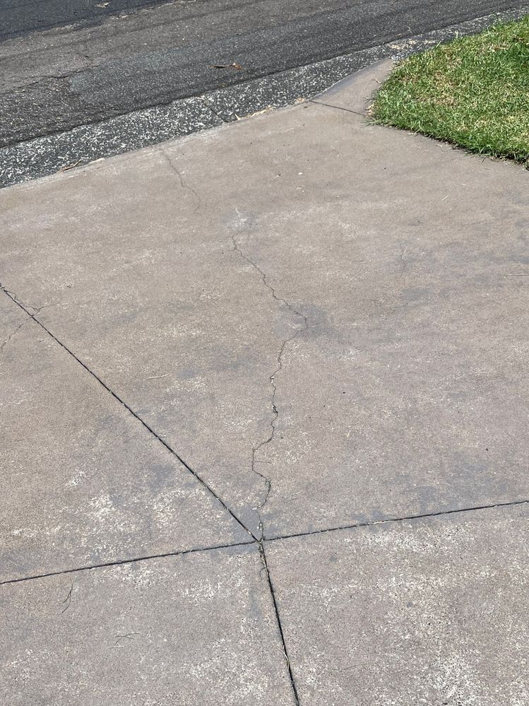

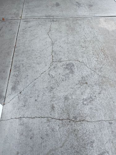

Hi, I have some long cracks in my driveway - are these suitable to fix myself and if so what products? Or would I be better paying someone to do the job?

Well  You  could simply use cement powder and water into a slurry  (extra  sand wont fit the fine cracks)
I t will fill the cracks as is but is is possible to recrack at a later dated.
Another way is
Sika 1L High Strength Epoxy Repair Adhesive Concrete Fix Kit
$60.78
  • Convenient kit - just mix and apply
  • Excellent adhesion to almost all substrates
  • High load capacity
  • Shrinkage free hardening
Sika Concrete Fix is an easy to mix and use, 2-component, high-strength, structural, smooth-paste epoxy adhesive comprised of Sikadur-33 Part A and Sikadur-33 Part B.
Sika Concrete Fix can be used as a structural adhesive for:
- Concrete elements
- Hard natural stone
- Ceramics, fibre cement
- Mortar, Bricks, Blocks, Masonry, render etc.
- Steel, Iron, Aluminium
- Wood
- Polyester, Epoxy
Sika Concrete Fix can be used on concrete to:
- Repair corners and edges
- Fill holes and voids
An other cheaper option  is
Earl's 1kg Concremate Expanding Cement
$21
Might need sanding level  with a  stone or brick.

It's great that you've received good advice from @Jewelleryrescue. Just to add to the suggestions made, I recommend using Gripset Betta 1L Concrete Crack Filler. Since the cracks are not very big this filler should sit in nicely between the cracks of the concrete. Please make sure to clean in between the concrete cracks before applying the filler.
Please make sure to wear personal protection such as gloves and goggles when working on your project.
