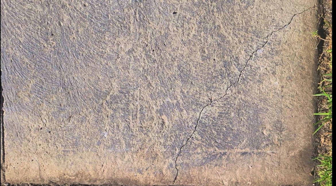

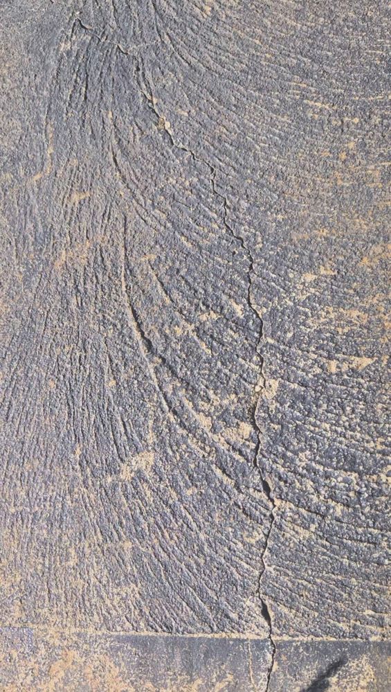

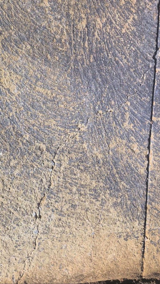

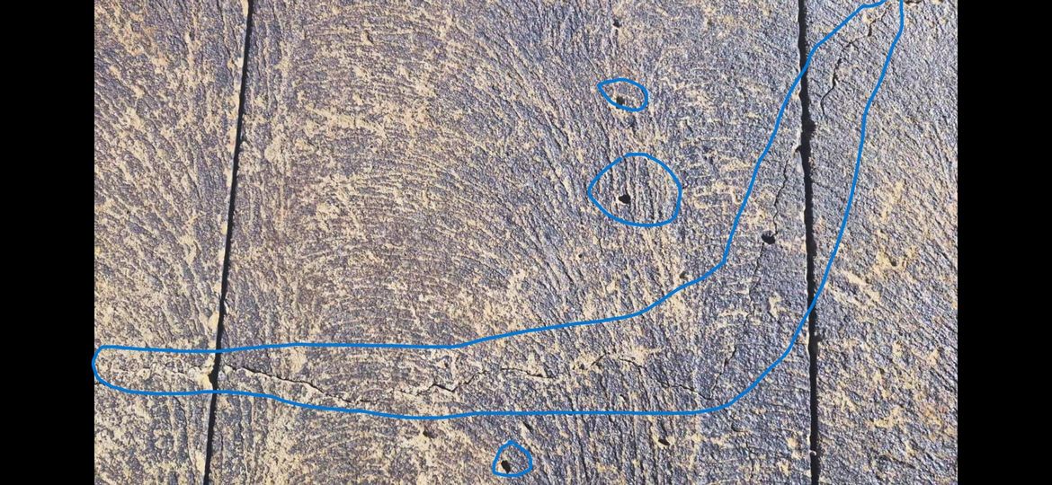

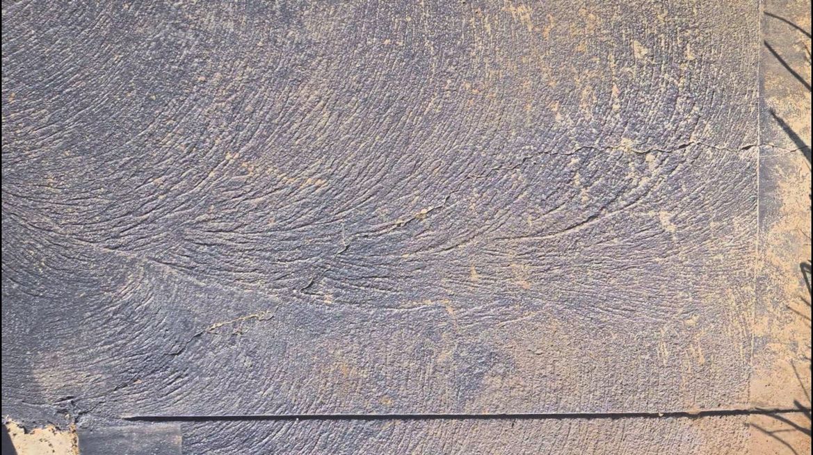

Hi Team,
Could you please advise on the best way (putty fillers or sealers?) to repair the cracks in my concrete apron? I’m planning to seal/paint the surface after the repairs—though that may happen at a later date—so I want to ensure the cracks are properly addressed beforehand.
I appreciate your guidance and any recommendations you can provide.
The faded dark gray color on the concrete is from the old sealant.

Hi EricL,
Thanks for your response. I was wondering—does Concremate work well for fine cracks too? Also, is it water-resistant?
Hello @LuckyMax
For the fine cracks you'll need to use a plastic paint scraper to spread the Concremate evenly. Once the Concremate fully cures it is water resistant.
Hi EricL,
In your expert opinion, would you recommend using a liquid sealant with a caulking gun over Concremate for treating fine cracks?
Hi @LuckyMax
Because you are planning on sealing and painting the surface of your concrete apron the repair material must dry hard and not soft or flexible. Painting or sealing over a flexible surface will be a weak point in the seal. It will flex and peel off, so it is best to have a hard surface repair so that there will be no weak points on the surface.
