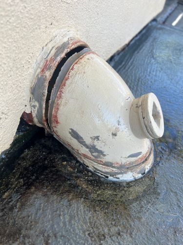

Hi, I’m hoping to fix my leaky ensuite pipe..
The pipe carries wastewater out from the shower base. If anyone knows the best way to go about the repair, any instructions & advice would be greatly appreciated.

I suspect that your outdoor slab has moved and has snapped the pipe off your wall. Please note that because this is plumbing related work, you'll need to engage the services of a registered plumber for safety and compliance. Generally speaking, the plumber will probably replace the elbow with something similar with an inspection junction. The concrete will need to be broken and taken apart so that they can get access to the pipework in the wall and base floor outside.
