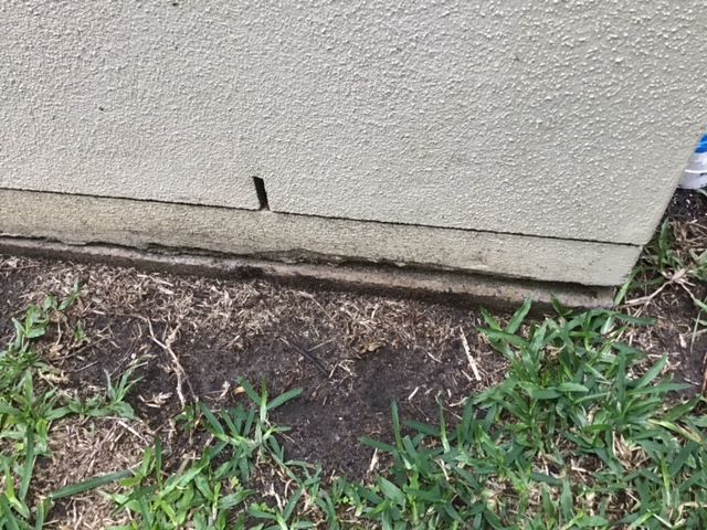

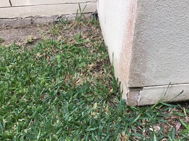

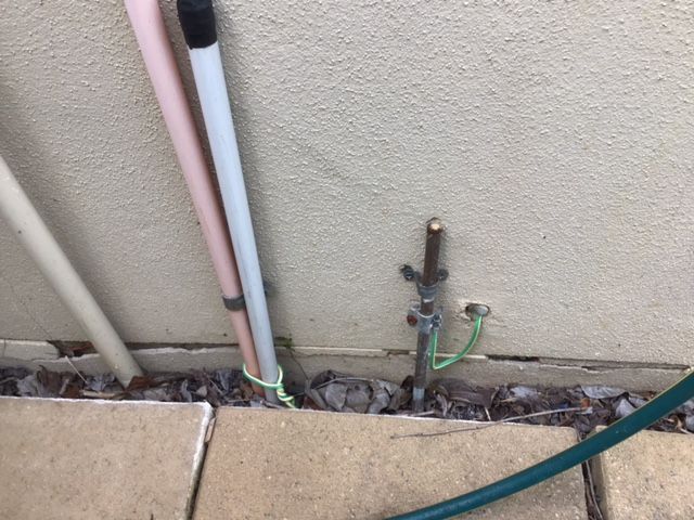

I've recently bought a house that has some signs of wear around the parging.
I've no experience really but my plan was to
-dig a ditch around the perimeter
-scrape and reconcrete/repair where the render was coming off badly.
-fill the ditch in with drainage gravel

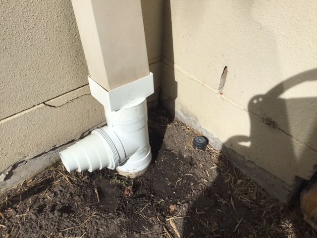

I've recently replaced the downpipe adapters as some had cracks and were leaking. The house eaves are very narrow so i suspect there is excess moisture pooling in this area when it rains and causing the erosion.

Id be doing pretty much what you suggest. Tho the last step of filling it in with drainage gravel maybe if I had placed a sleeved corrugated pipe in the trench first? The damage does look like its traveled up from the ground so the water needs somewhere to drain to?
