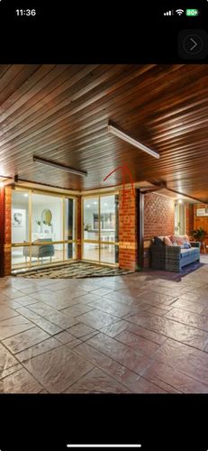

I have 12V LED tube lights installed in my alfresco area (as shown in the attached screenshot), but they’re no longer working, so I’m looking to replace them.

The below is a screenshot how the light holder looks like, the image probably is not super clear but it kind of will give you an idea I guess

Do you have any photos you can share of the light fittings and the space where they are installed?
We would need to confirm that whatever lights you select are compatible with the fittings.
