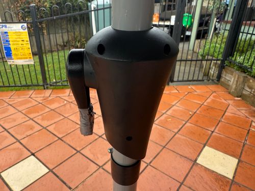

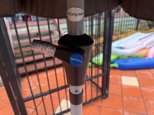

We have a Marquee Umbrella on which the winder handle has broken. I've ordered a replacement through Special Orders and am trying to see how to remove the broken one. Any assistance appreciated?

Hi JacobZ
see attached photos please
igel
The three recessed screws within the holes on the side of the handle module would likely be the best place to start. Once undone, they'll likely allow it to come apart and give access to the handle and what's retaining it inside the module. There might be a clip or nut that needs to be undone to release it.
