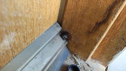

Currently, it's pretty much a screw which doesn't push the seal back. Images with and without cam. Cam is just hanging there. It does work until it falls off. Would it be possible to glue it?

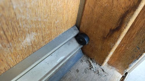

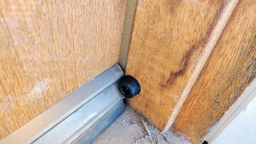

I finally got a chance to buy the bumpers and so far it's working! Not sure how long the adhesive will last, but I can always glue and screw it if needed.
Re: Automatic Doorseal cam replacement
Looks great @Kalliste! Well done.
I'd put a screw in it now if everything lined up and functioned correctly. The adhesive is likely to last only briefly, and the screw will be a permanent fix.
Many thanks for the update.
I mostly didn't screw it in because I was lazy :laugh: But, I have done this now at your suggestion! Thanks again for your help.
