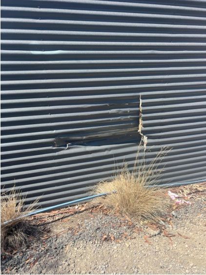

Hi Everyone,
Can someone please let me know where I can find the similar panels for an existing fence
It is mentioned on the sheet – Made by Bluescope AS/NZS 2728 CC441h W59594  2-DEC-2021.
The project location is in West Melbourne.

Welcome to the Bunnings Workshop community @rubal1. It's wonderful to have you join us, and many thanks for your question about replacing sheeting.
You would need to verify the profile and then speak with our Special Orders team at your nearest Bunnings store. They can contact our Colourbond sheeting suppliers to see if they have a matching profile. We deal with Lysaght, and you can see some of the profiles on their webpage. Depending on the size of the corrugations, it could be CUSTOM ORB, CUSTOM ORB ACCENT 21 or MINI ORB. If you click on the Technical Info button, it will tell you the size.
You'll also need to determine if the sheeting has a Colourbond coloured coating on it or whether it has been painted. If it's a Colorbond coating, we have colour swatches in store to assist in colour matching for your order.
