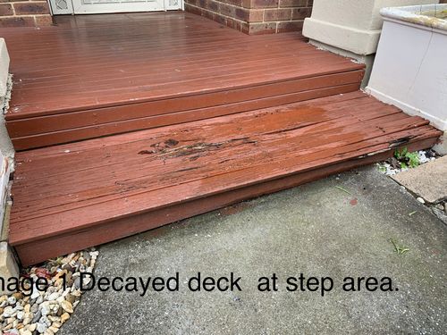

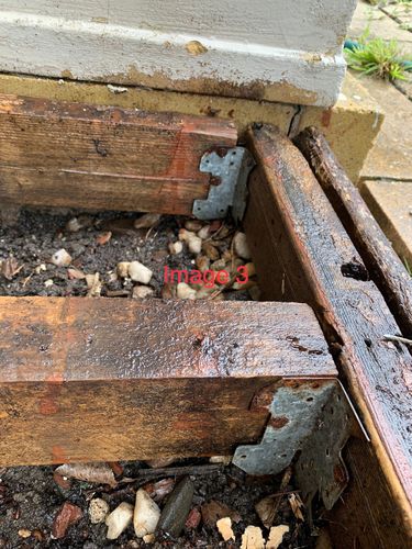

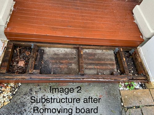

After having great advice from you, I have started work on to replace decayed deck at step area (refer attached Image 1 as a beginner When I removed a couple of lengths of decayed decking boards at the step area, I found that the deck structure has begun to decay (refer attached Image 2).

Q1: My current decking structure is more than 18 years old. Do you recommend changing the substructure at this stage, if yes then what sort of timber, nails/screw I can use it for this external decking. In this situation any suggestion to rebuild the substructure is highly appreciated. Do I suppose to put any protector over timber?.
Q2: How I can remove joist hangers to separate timber pieces (refer attached Image 3).

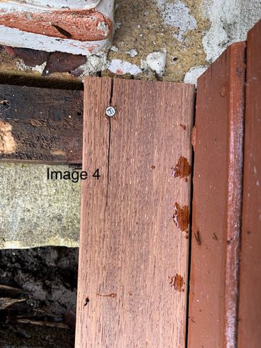

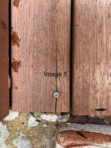

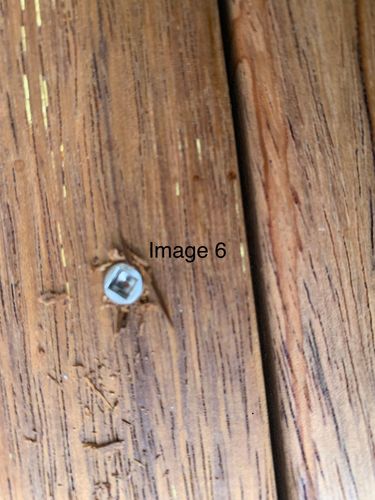

Q3: When I was inserting the Macsim 8G x 50 SS Decking Screws specially at the edge of the board by using drill driver (as shown in Image A) then it cracked the board (refer image 4 and 5) and even I damaged the board when inserted the screw (refer attached image 6).  Do I need to do a pre-drills pilot holes at each point before I put a deck screw or else? Please kindly guide how I could avoid cracking or damaging of boards and able to finish off as even and professional finish.

The step frame appears to be starting to decay, and I'd suggest that now would be the best time to replace it. Hopefully, the frame in the upper deck section doesn't need replacing. I'd suggest using the same size H3-treated framing timber that is there currently. Joist hangers can be used, or you might like to screw the sections together with treated Pine screws. Given you've experienced this decay, it might be best to paint the underside and sides of the timber with bitumen paint
To remove the timber frame, I'd recommend cutting it up with a saw, as it would be difficult to remove the joist hangers.
Those screws need to have holes pre-drilled and countersunk, and you can use a pilot drill/counter-sinking bit for that. Alternatively, you can switch to self-drilling decking screws. The Zenith 12G x 50mm Stainless Steel Self Drilling Decking Screws - 500 Pack would likely be the best value for money.

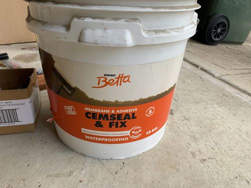

am progressing on the project. Last sunday I bought some decking related material from Bunnigs. You have advised me to use Bitumen paint to protect the timber from rain water. I was about to buy your recommended paint and thats is going to cost me ~&20. A guy from Bunnings has advised me that instead of getting smaller container of Bitumen paint in $20, i may purchase a 15L Betta Cemseal & Fix (photo attached) on discounted price of $6. I bought that sealed bucket. After reaching home, I have noticed following even without removing the seal of the bucket. (1) strong smell of solvent (2) felt some thing is settled solid in the bucket. When I tilt the bucket I felt something in a solid form in one piece and that single solid piece moving away from internail surface of the
Bucjet. i am not sure whether i can remove the bucket seal and look inside bucket or just return the bucket to Bunnings and will get Bitumen paint that you have suggested for water proofing.
Please  advice me whether i can use Betta Chemseal & Fix from the above reffered bucket instead and whether it is easy to apply on treated timber frames or and concrete (under deck) in comparison to Bitumen paint. Please also let me know whether the material in the bucket is expired or not.
Look forward to hearing from you.
Thanks
syed
Re: How to replace decayed decking?
Hello @smhasnain
I suggest returning the Betta Chemseal if you suspect that it has gone off and is no longer in good condition. I propose staying with @MitchellMc's recommendation of using bitumen paint
My best advice is to make sure that the timber is totally dry before you apply the bitumen paint. You don't want to trap any residual moisture in the timber as this will only accelerate its deterioration.
