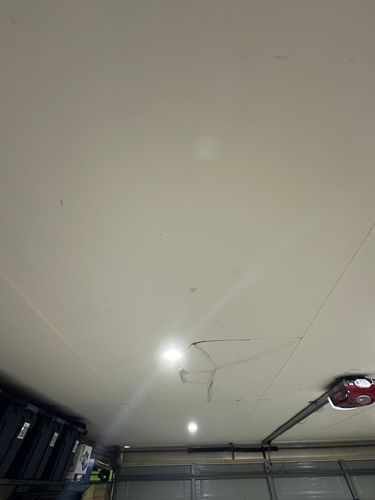

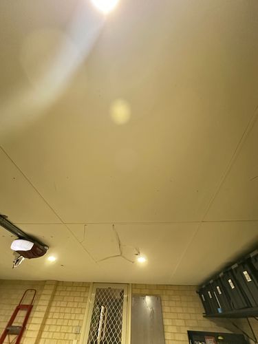

Hello, how can I replace this damaged eaves sheet?
Thanks guys for the replies.
Here are the photos.
it’s a James Hardie Fibre Cement sheet.
I mistakenly stepped on it while checking my roof tiles from inside 🫣!

Thank you for sharing the photos of your ceiling. I was wondering what caused the damage and saw your explanation at the bottom of the page. Did you try to fix the damage on your garage ceiling? Did you use adhesive to join them back together? It appears to be stable, and it might be possible to fill in the cracks with Parfix 1kg Ready To Use Multipurpose Filler.
However, if they are unstable and the broken pieces are just barely holding in on then it will be necessary to replace them.

Hi @daniellongo,
The last time I helped a friend in a similar situation we braced the ceiling and I did the job in the roof with 3mm plywood and building adhesive.

@EricL Yeah they're are broken pieces and I had to put a fair a mount of tape to have them in place. Ideally I would like to change it, but if there's a way of repairing the fibre cement I'm down to it as well.

Sad to say I would replace the sheet, it would look the tidiest and quiet possibly be the easiest (apart from getting the sheet home
) to do.
Remove the beading around the edge of the sheet (the other sheets should be tacked up and the trim just dressing but check as you go)
Then remove the sheet and replace. Use the same type of tacks/screws that you can see on the other sheets. Im not sure if I would use a compound to help glue it as it may change the height distance compared to the already installed sheets too noticably.
To cut the sheet if needed, scour with a sharp knife and then snap the section along the score line. Works surprisingly well.

This is not an easy replacement sheet job being overhead. The joint cover strips need to be first removed, then the sheet can be removed. A new sheet of exactly the same dimensions needs to be cut and nailed into place and the cover strips replaced. Sounds straight forward but not. The sheets were originally installed starting from one end. So to replace from the missed will be a high-level exercise.
Alternatively, you could get back in the roof if you trust yourself and install several battens between the ceiling joists. Then this will give you multiple points to nail secure the cracked area to. Fill any gaps with The Parafix filler @EricL suggested, though a 500g tub will be plenty.

Thank you @Dave-1, @EricL and @Nailbag, although I would love to fix it I'll try to change the sheet as I already purchased it, but keep putting it off due to the complexity.
