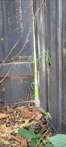

A small portion at the top of one of our fence palings seems to have broken off (thinking maybe during some recent storms).
Any suggestions of how we would go about replacing this? The wood sitting horizontally across the fence also appears to stop short for some reason.
To add some additional complexity, the other side of the fence is currently an empty lot (slated for some construction to start in a few months) so not sure how to get to the other side/who to work with who owns the land so hoping to manage on our side.
The bottom of the fence is also pulling away a little bit to the side of this too
Any guidance would be really appreciated :smile:

In order to repair your fence from your side, I suggest cutting the top portion of the damaged area straight. Next, measure the area that needs to be replaced. I recommend using standard fence paling and painting it the same colour as your fence.
I've sketched an image below to give you an idea of how it can be repaired from your side. In regards to the gap at the bottom, I suggest just placing the remainder of your paling and attaching it to the one that's closest to the end of the fence.
