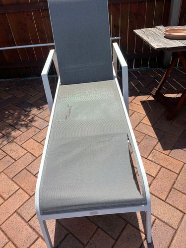

How to replace sun lounge fabric?
my sun lounge needs a replacement seat. Are these available please?
Re: How to replace sun lounge fabric?
Hi @Supersession84,
As the material is sewn to the frame of the sun lounge, and is not a removable part, replacing it would be tricky and potentially unsafe.
For the time and effort it would take, it might just be easier to replace the sun lounge as a whole. This Marquee Sling Steel Sun Lounger might be a suitable option.
Let me know what you think.

Re: Sun lounge seat replacement
Hi @Supersession84,
I'd also encourage you to replace the sun lounge. We've discussed repair with our manufacturer before, and they have advised against it due to the safety risk. The sling fabric is typically installed with a machine, and any repair wouldn't be as strong. I also share their concerns, as if your repair were to fail, it could cause significant injury.
unfortunately the manufacturer does not supply replacement slings for these sun lounges.
Not to safety factor, but not worth while for them.
They simply want you to buy an other.
I've got the same problem with these lounges.
Thay are not installed by machines, they the tracks are bolted to the frame.
Unbolt the tracks, slide out the fabric and get a upholsterer to make them for if its price affective.
I have 2 lounges exactly like the one in the photo at head of this topic - lounges 3, maybe 4, years old.  I expected to find replacement seats due to the bolt off stretcher framing, less sure of the back which would have to slide into frame.  I searched Bunnings for parts but none - this series of posts confirms.  The alternative upholstery method would work - i have had canvas in past for Qld squatters chair but its old timber failed as well.  These chairs frames are good but $99 suggested equivalents make it cheaper / easier to take good frames to dump.

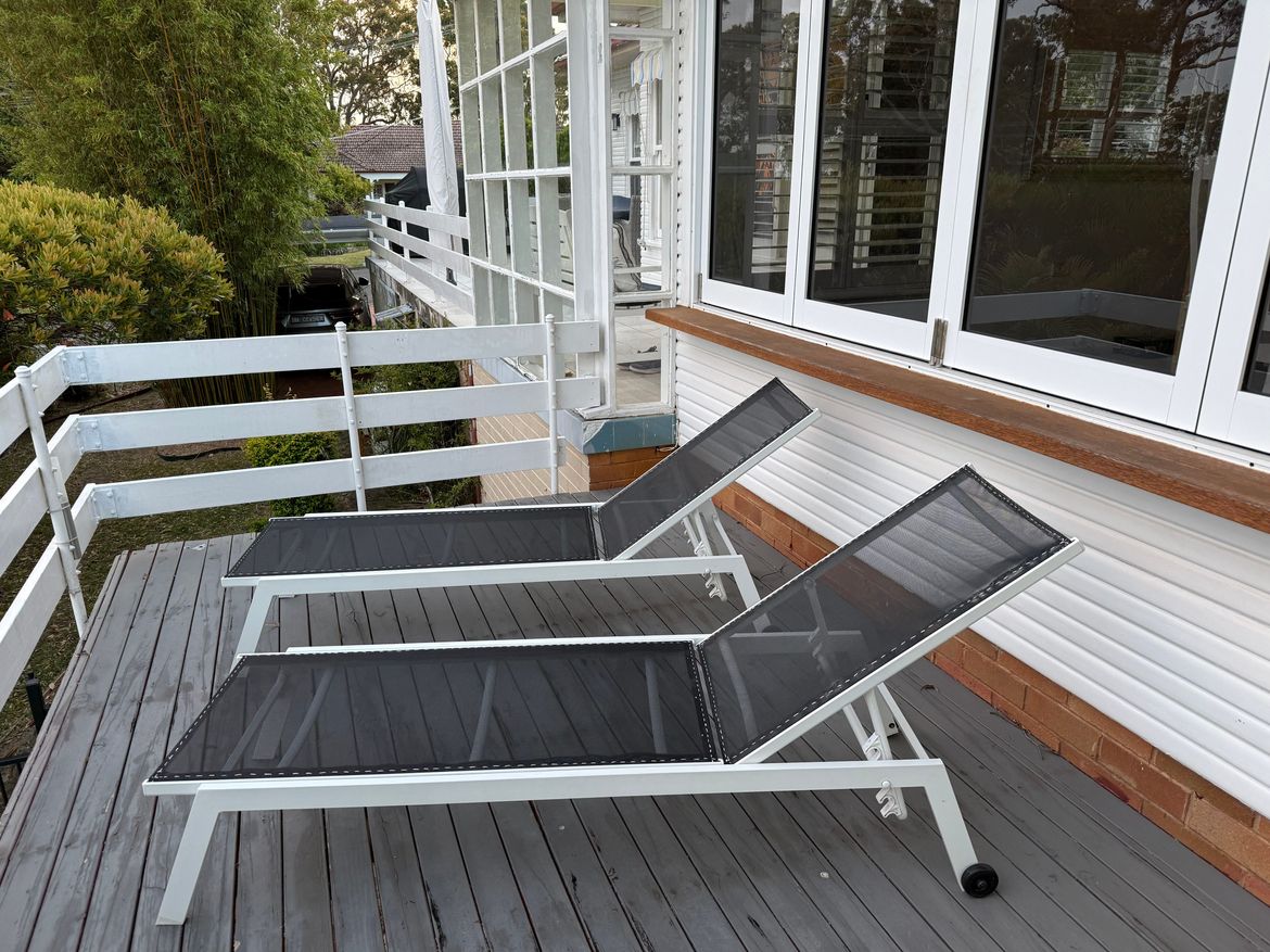

Here’s an idea if you don’t mind doing a little sewing.
I replaced the torn fabric on our old Sun Lounges with Cyclone Pet safe Fly screen. Super strong and easy to work with.
