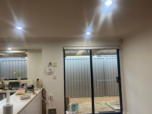

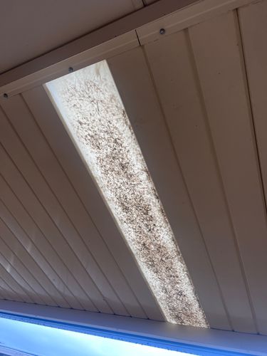

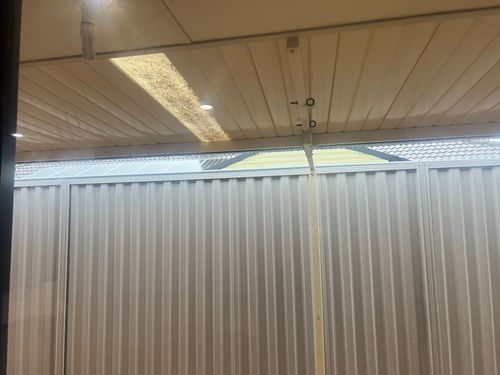

Hi
The sheets have been dirty and they are not getting cleaned. I was looking at possible options to replace them with transparent sheet also adding additional sheet for more light to come in. This is a flat patio on side of house and is the only area from where natural light can come into the house.

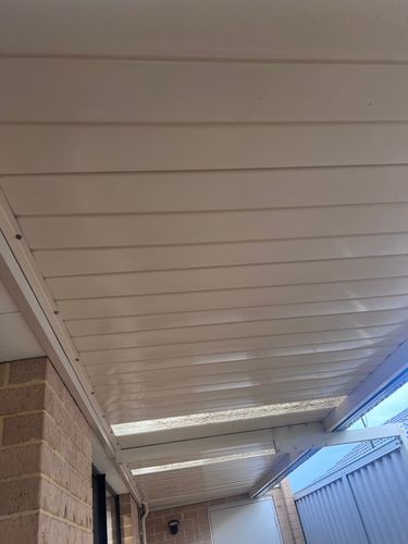

That structure has been altered/modified and from my perch over here two support posts have been relocated over to the fence and rafter extensions installed.
Not good... virtually no load-bearing capacity.

The Trimdeck that @AlanM52 has mentioned seems like a likely replacement, however, we'd have to see the existing roofing material from the top to work out how it could be replaced.
If you can safely take some photos showing the top of the roof structure, this would certainly help.
