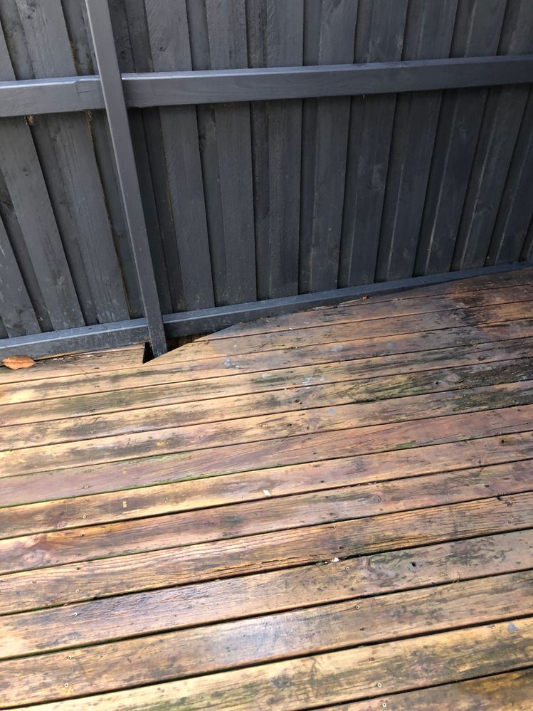

Hello I have just painted my garden fence which I'm pretty happy with. Now my deck looks terrible in comparison! ijust gave it a clean with White Knight to get rid of a lot of the moss. I've never painted or oiled a deck before so have no idea what I need to do. It also got a few splashes of Dulux Domino from the fence painting which I need to cover. There is also a slightly rotten patch where leaves have been sitting. What is the best thing to do with it? Thanks for your help.
Rosemary
Hi @RosemaryK,
You should find this guide useful: Refresh and renew your timber deck. If you have a pressure washer, that would be a good place to start. There looks to be a substantial about of moss/mildew which could be blasted off. You should also use Cabot's 1L Deck Clean and an Oates Long Handle Deck Scrub Brush to remove any contaminants on the timber. Once the timber is clean, you can thoroughly inspect it and replace any rotted boards. If the deck has deteriorated, you might also need to give it a sand.
Once you've cleaned the deck, feel free to update us with some images and we can advise whether the sanding process will be necessary before oiling. The main priority at the moment is getting the deck perfectly clean and repairing damage.

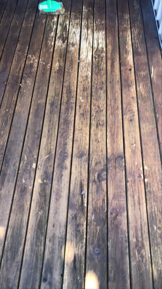

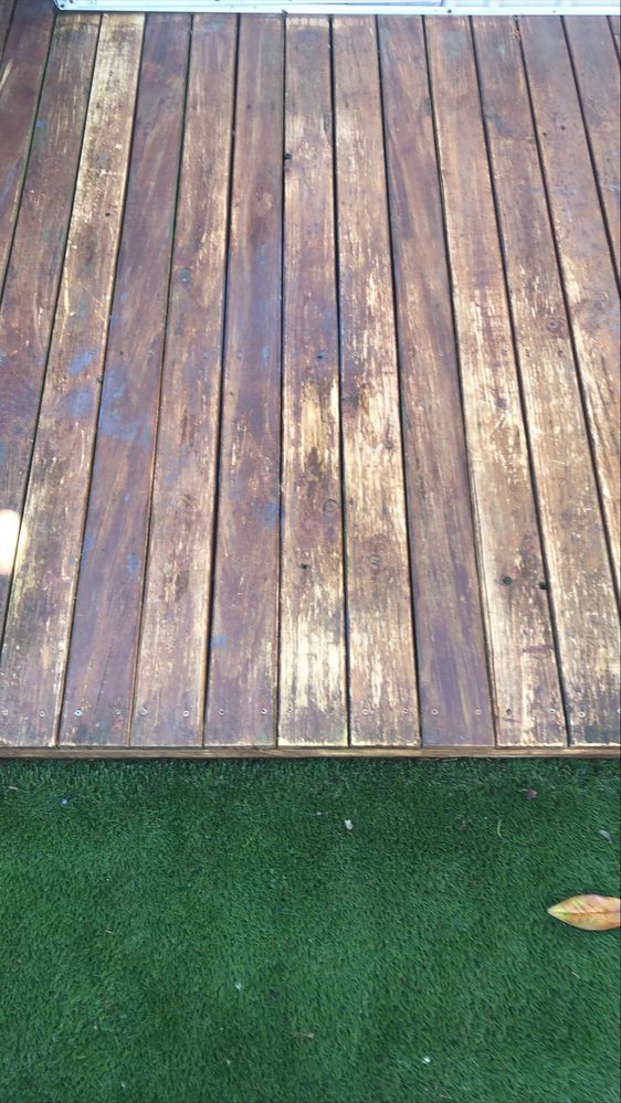

Here are some photos after I scrubbed with the Deck Clean and a hose. It doesn't look any different to before. I cant easily get my hands on a gurney.
Rosemary
That is a deck that definitely needs a sanding to be fully restored @RosemaryK. The dirt and grime have fully penetrated the timber fibres, and you'd need to sand the decking back to fresh timber. Given what you mentioned above, you might want to coat the deck with an oil and stain combination, so you can move on to other projects. The darker colours will probably disguise the deterioration to a certain extent.
Sorry Mitchell to clarify. Are you saying it really should be sanded but with time,money and effort being an issue I could do an oil and stain combination? Or are you saying I need to do sanding plus the oil and stain combination to be any benefit? Im really grateful for your advice here!
Rosemary
To complete a full restoration which will result in an amazing-looking deck, you need to sand first @RosemaryK. If sanding is out of the question, then I'd suggest it would be still worth applying an oil and stain. Even without sanding, it should hopefully make the deck look better than what it currently does. Unfortunately, because of the discolouration on the deck, the results you see might be less than satisfactory.
