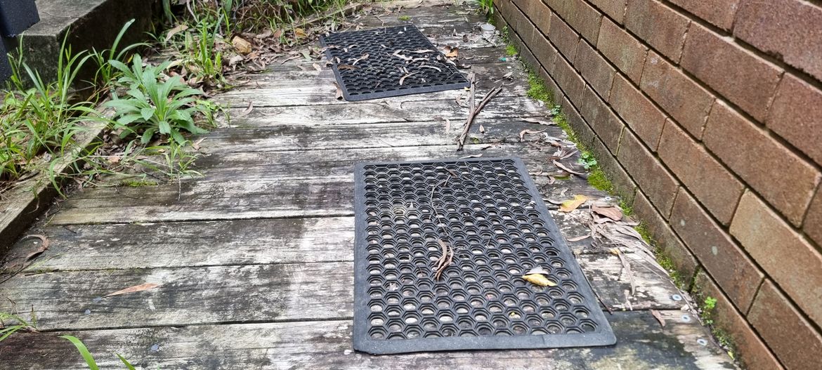

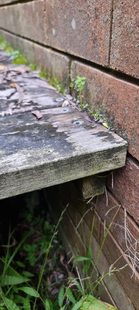

Hi folks,
We have this small "deck" behind our house, which is just used to access the fuse box and under the house. It's not protected and exposed to weather. I don't need it to be pretty as it's out of sight but I want it to last for as long as possible and not be a hazard (It has become slippery)
I can't tell the type of wood..
What would you the best approach? Sanding and oiling/painting? Any specific treatment to be applied?
Cheers
Julien
20250529_101155.jpg20250529_101200.jpg.
Re: Restore old decking
Hello @julienf
It appears that the deck is still in sound condition. I suggest giving the deck a good clean and removing all the vegetation that has started to grow on it. Once the deck is clean, I recommend sanding the surface back to remove all the old timber fibres on the surface. Give the surface one more wash to remove all the sanding dust and let the surface fully dry off. Once it is totally dry you can then oil or stain the surface to your preferred colour.

Crystal clear. Thank you @EricL
