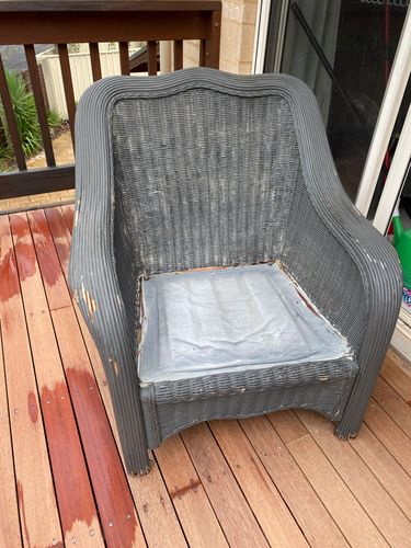

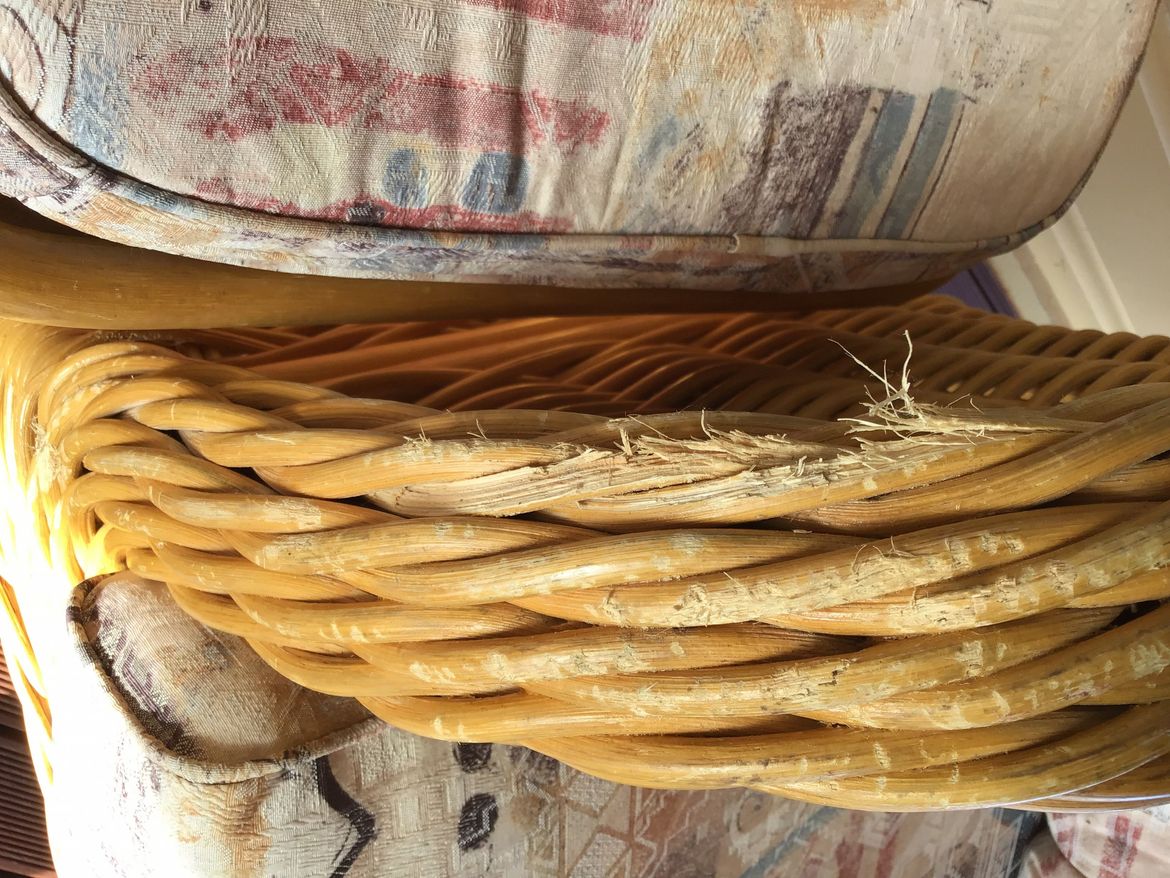

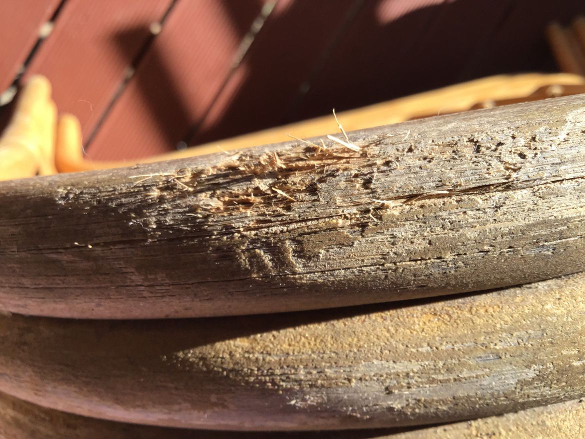

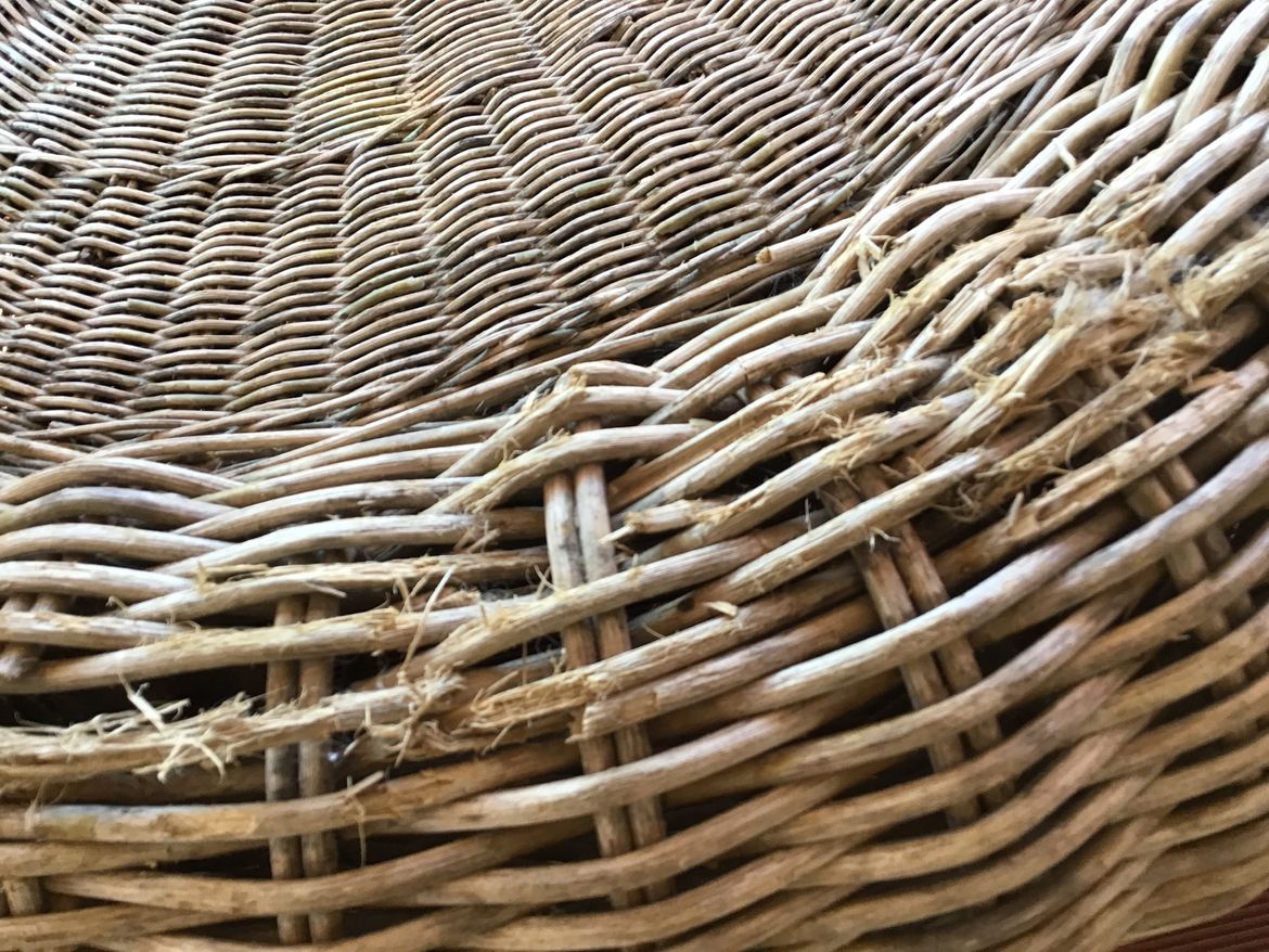

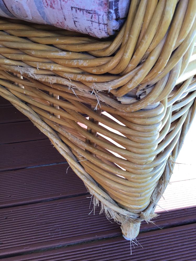

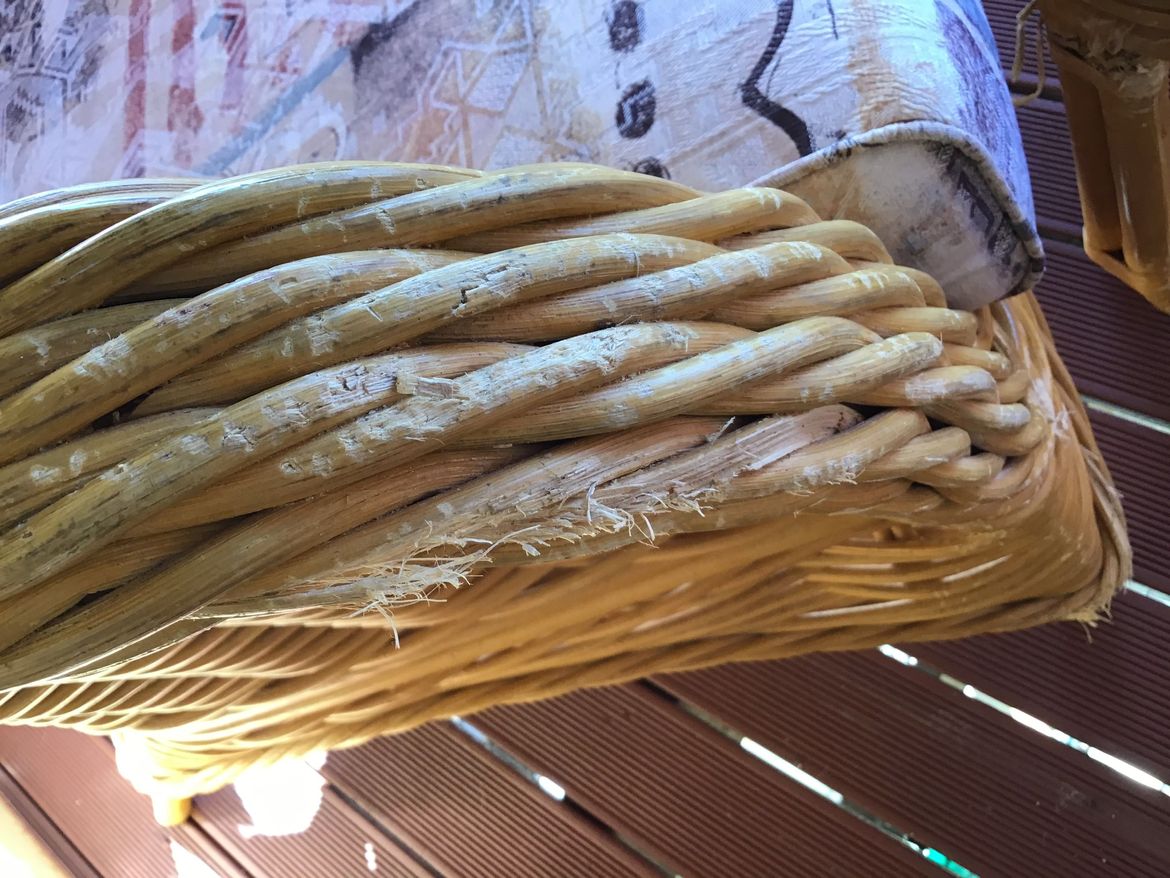

Hi there. Any suggestions as to how to restore these salvaged wicker/rattan/bamboo/cane pieces? They are meant for our own enjoyment. I would just like to cheer them up a little with new cushions and perhaps somehow restore some of the damage that appears to have been caused by pet birds.
The middle table will need to be painted white, I think. Would like suggestions on how to go about that.
However, the cane coloured ones I hope to be able to restore keeping the original cane colour. Any ideas would be much appreciated.

Looking at the photos you've posted, I can see that some of them have been exposed to extensive weather damage. I recommend using Intergrain 1L UltraPrep Timber Cleaner on the extremely weathered pieces. Please make sure to use gloves and safety glasses when using this cleaner.
As for the damaged areas, I suggest using Selleys 500mL Aquadhere PVA Wood Glue Exterior Adhesive. The steps to restoration involve sanding, washing and then prepping the furniture for painting. It's important to remove any loose paint before you put on new paint on the furniture surface.
Here is a link to our best advice article on this topic: How to restore cane furniture?
Here is a handy step-by-step guide: How to restore wooden furniture.

We've made some progress already. We found a bottle of diggers anti-mould linseed oil in the garage and this worked wonders on the two cane chairs.

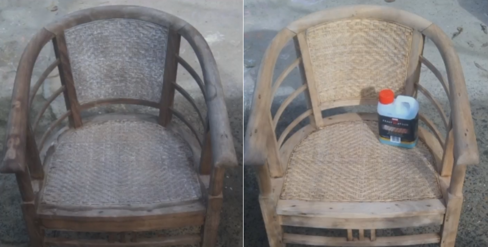

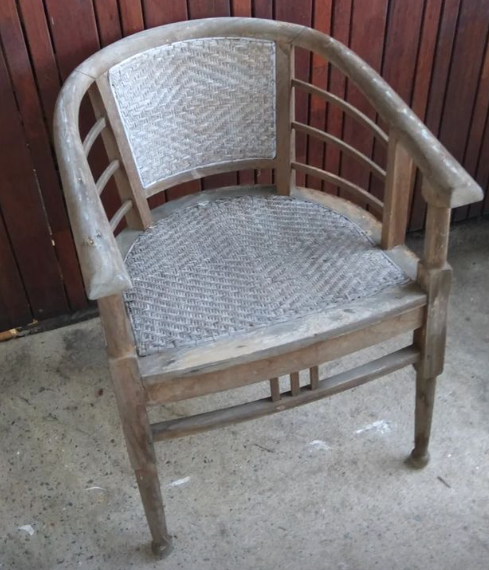

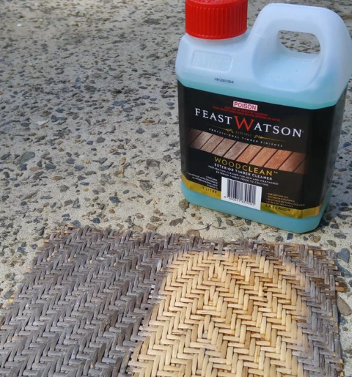

I'd recommend you try Feast Watson Woodclean over the Intergrain product. They are basically the same product, but the Feast Watson version has the addition of Hydrochloric acid, which makes it better at stripping coatings from timber. Hopefully, it should break down that hardened lacquer. You'll need to use a plastic bristle brush to agitate the solution on the furniture and dislodge the coating. Be warned, though, when you see how well it restores wicker and rattan, you might not want to paint it.
Here are some images of a piece of furniture I restored using the Feast Watson product. As easy as pouring the solution on and giving it a gentle scrub. I was amazed and how well it worked.
ME_1
Re: How to restore salvaged wicker/cane/bamboo/rattan furniture?
That looks amazing and is exactly what I’m after. Thank you! Will keep you posted.

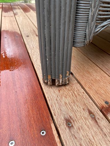

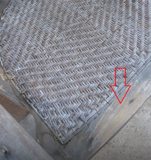

I have 2 cane chairs that I’d like to restore right back to natural wicker. They’ve probably had 3 or more coats of paint on them over their lifetime.
I see you recommended for @ME_1 to use the Feast Watson Woodclean product that has some grunt, but will it remove the layers of paint on my chairs, or do you recommend something else?
Also, what do you recommend I use to repair the missing ‘foot’ trimming?
Thank you for your help.
Welcome to the Bunnings Workshop community @Guesthouse. It's splendid to have you join us, and many thanks for your question about restoring wicker.
You'd need to use a paint stripper for your chairs. However, there are thousands of nooks and crannies that you're not going to be able to remove the paint from, even with the stripper. You'll likely be able to get the majority of the paint off the surface with some patience, but you'll never be able to remove it all. Given that, I'd recommend you paint them in the colour of your choosing, which will refresh their look. I'm all for restoring them to the bare wicker, but I don't think it's possible.
Real wicker is a relatively specialised product, and I'm not aware of where you could acquire it. If you were going to re-paint, I suspect that a few winds of clothesline around the feet could mimic wicker adequately. I was actually re-stringing my clothesline a few weeks back and thought that the line looked like wicker.
