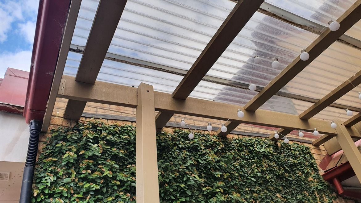

Hi workshop community,

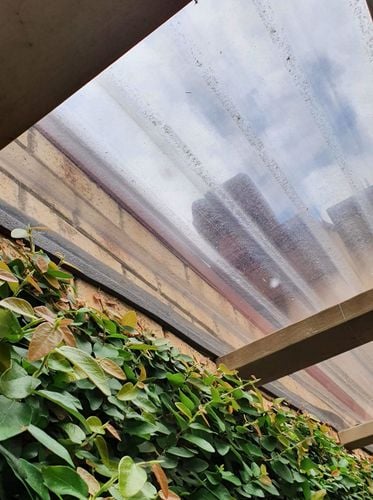

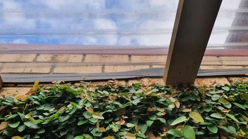

I have a decked pergola area with polycarbonate roofing adjacent to a brick wall. There is a gap of approx 1 cm between the edge of the polycarbonate and the wall and during heavier rain, the deck ends up getting wet! The previous owner who had the pergola installed did not have any flashing or similar put in to prevent water leaking onto the deck.
As a temporary measure, I've inserted a 10 mm polyethylene foam in the gap which understandably fails to improve the situation - the water just ends up running behind the foam and down the wall.
Can anyone suggest a solution to seal the gap? I would be interested if anyone had a solution other than flashing that might be just as effective.
Cheers,
Daniel

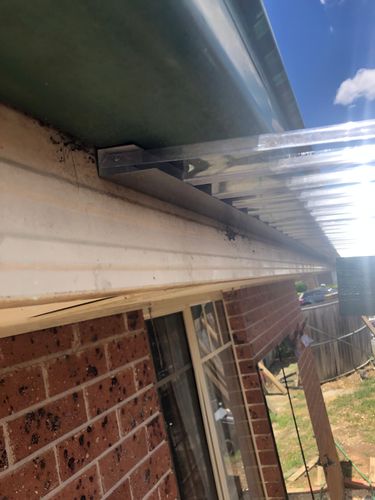

Hi @MitchellMc and @dyfuse
I found this purpose built Roof sheeting solution for myself and @dyfuse completly by accident instore and it fits the bill perfectly as it was designed to do and it can be done completely from under roof. @MitchellMc would know I recently extended polycarbonate roofing the house facia so no rain in outdoor room.
Oh more colours avaliable this is an example.

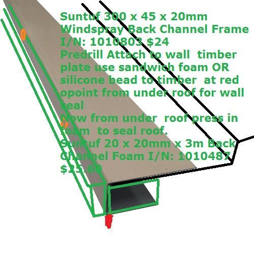

https://www.bunnings.com.au/suntuf-300-x-45-x-20mm-classic-cream-back-channel-frame_p1010805
https://www.bunnings.com.au/suntuf-20-x-20mm-x-3m-back-channel-foam_p1010487
Suntuf 300 x 45 x 20mm Windspray Back Channel Frame I/N: 1010803 $24
Predrill channel use sandwich foam (i like the concrete expansion foam to 10mm thick some time is has pull away strips or cut it to size) and pre silicone it on and let it set over night Easier to juggle up high when set. Then when you screw channel to wall the foam will seal it and allow movment OR optional silicone bead to timber and channel join all from underneath access for wall seal.
When installing channel roll it up and over roof edge Long side on top of sheeting there is a 20 mm gap in channel to put screw though your predrilled channel into the wood at nice even hight with the roof resting natuerally against top channel longer lip.
Now its a simple process from underneath to neatly push in custom sealing foam along bottom lip try to keep foam square shape if possible.
No roof access required .

Those two suntuf items are commercially designed and made you might need to address this issue with them and or advise Bunning not to sell them . They are dead easy to install .

I never see this back channel before at Bunnings as it not in the metal area so I was pleased to share especially as I just installed it too and had first hand knowlegde.
I was just using the back channel a super simple solution purpose made.
I flipped the back channel as water was not an issue here but if it was we could just add pre cut foam siloette lengths to seal back channel to roofing from underneath.
No wind rattle either.
