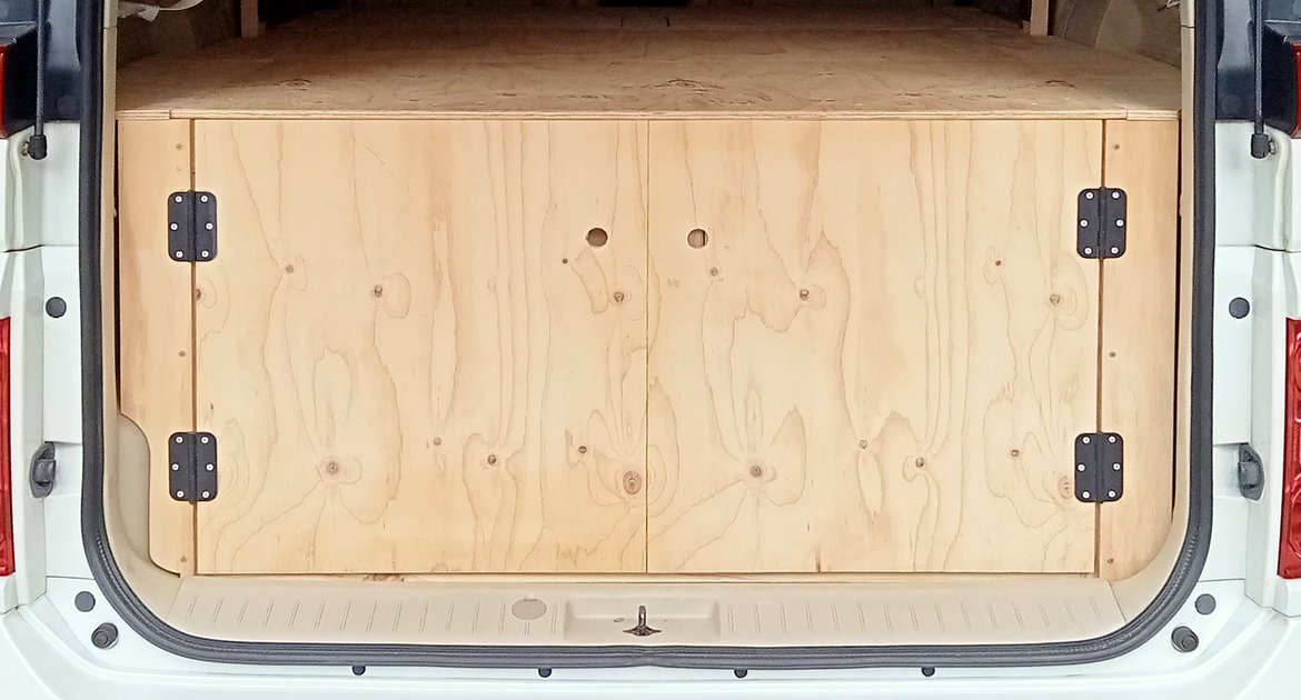

also, the very back timber doors I want to stain a colour - again, I will need to find out the best stain stuff I need / how to apply (12mm marine ply)

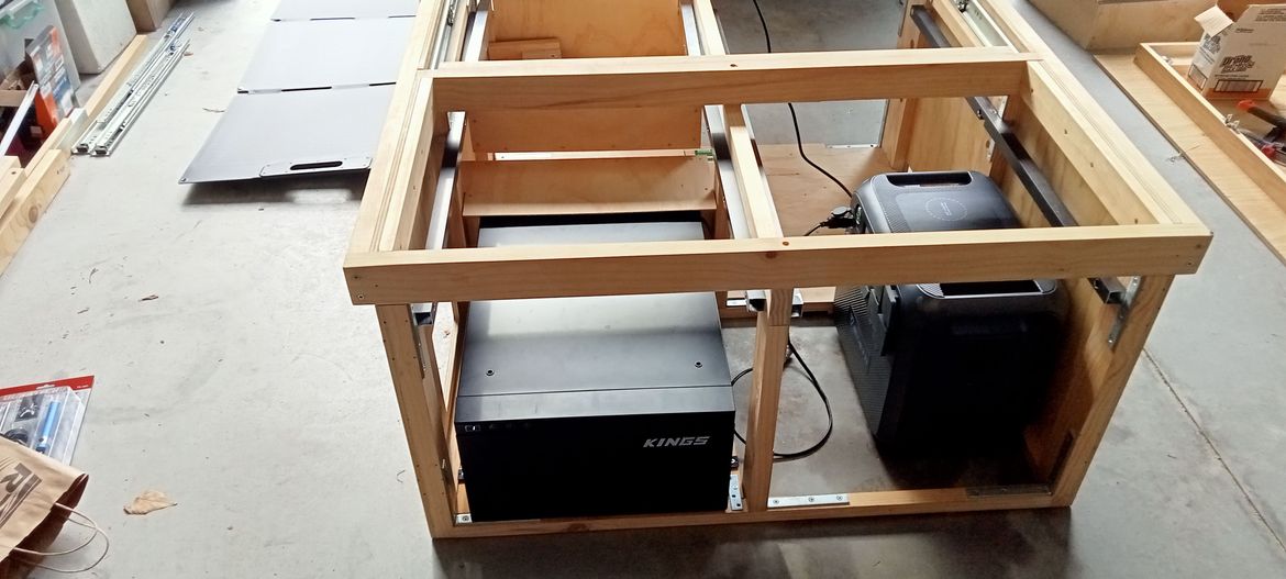

yeah, actually, being a multidisciplined engineer, designing this was pretty easy for me (building it was, umm... "interesting") with 100% focus on building a modular system that completely comes out - can be removed/put back in with 1 person in under 10 min - 6 bolts and 4 screws
so I can paint this out of the van and close up the garage while it dries - while the build is in the garage getting painted, all the electrics can be done in the van

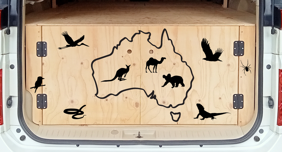

The plan is to actually Woodburn some art on those back doors - a cool arty map of Australia then stain in a dark reddish colour trying to keep the wood grain, then seal

I love the idea of the wood burnt map of Australia; it gives it that personal touch that will really make it home.

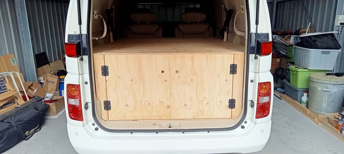

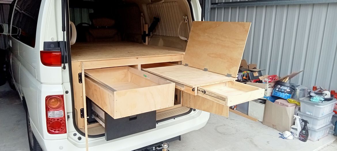

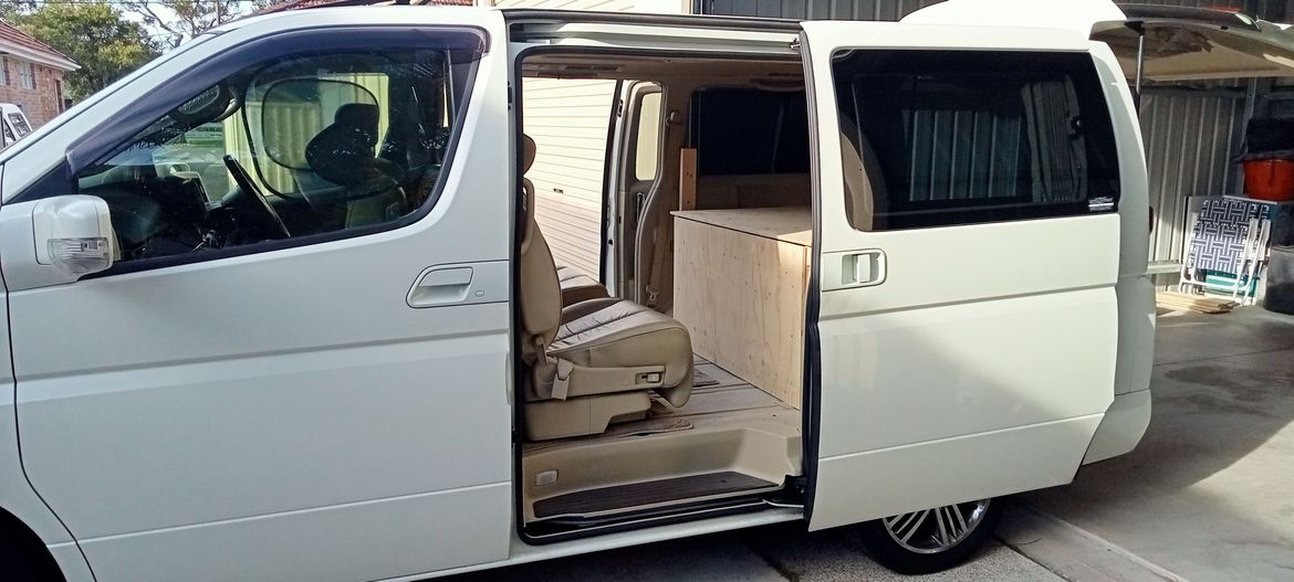

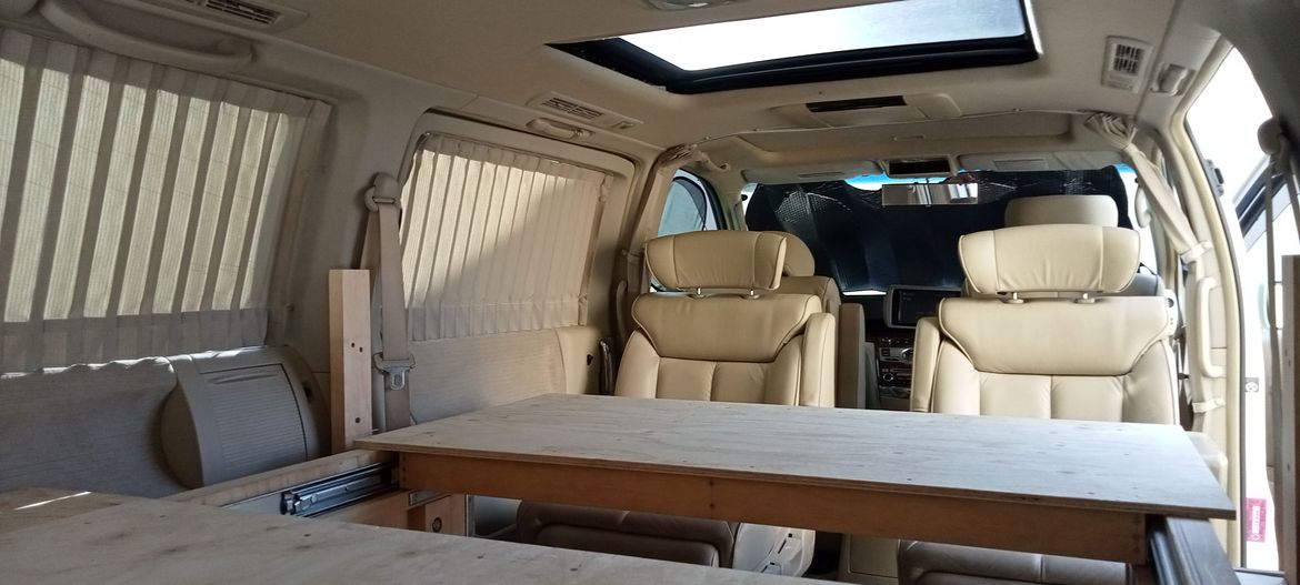

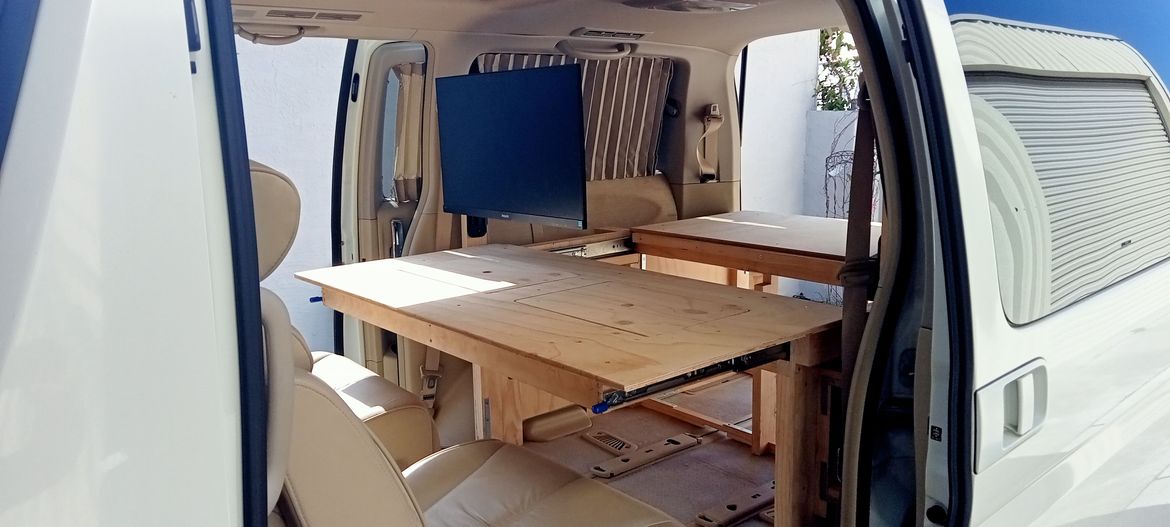

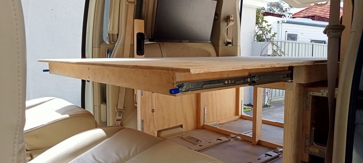

I have been asked a few times for the design of this one from various groups and things I also plan after I get on the road to publishing the complete design prob, for a 5-buck donation, maybe or just free
This is a speciality build for Nissan Elgrand E51 series 2 Import, being a bit of a nice entry low-key luxury
the electric sunroofs, electric doors and curtains are all factory - the build is around keeping the van as factory as possible or looking factory as possible
It has all heated leather seating - and the second-row seats rotate 180 to face the front or back (office captain seats) - as an import, it is plated and registered as a "camper"; however, it maintains 4 legal seats/belts as a 4 person passenger
the primary focus of this build is "Mobile office first" sleeper/kitchenette second - both of us are digital nomads, this van has 3 configs
1. 2 Seat mobile office - sat internet, 2x PC workstations, 2kw solar generator
2. sleeper - plenty of room for 2 other than the compromise of the low ceiling - no room for sitting up in bed (unless you stick ya head out of the sunroof lol)
3. kitchenette - induction cooktop, large electric frying pan, fridge and a portable firepit or those grill burgers with beer on Friday nights
the sunroof provides the viewing deck and launch zone for the drone
other mods include Bluetooth-controlled lighting - disco lights if we want, lol, awesome 2x media screens, android media box in dash/roof drop-down, and Bose sound - still deciding on the 900pce fibre optic light show system (maybe, maybe not - more of a time issue with that idea )
upgraded throttle computer with launch mode lol uses about 100L pr premium fuel to get across the intersection but does it with the front wheels off the road...(not quite but it feels like it, and is fun to be the first off the mark... ) has eco mode for using not much fuel cruising around
other electrics, including temp-controlled ducted venting
tinted windows + made-to-size UV shades on all windows + curtains - (also provides total inside blackout for video editing) this thing is very comfortable to get into even after being parked in 40-degree heat for 8 hours. It often remains cooler inside than outside - not including the ducted venting - which will be set at 50 degrees and automatically turn on / off when unattended
Other goals were keeping it "stealth", not looking like a camper, and keeping it under 2.0m in height - good for most carparks
later this month; it gets the tyre upgrade and airbags. There are a few other things I might do, but it is now becoming a focus on getting the project wrapped up and out the door before it turns into a rabbit hole.
a couple of progress photos below

Thank you very much for sharing all those details of your build. It certainly looks very stealthy as the camper side is well hidden behind the rear seats, but the transformation into a sleeping area is quite impressive. I love the office configuration. I'm sure there will be some amazing sights while you type on your keyboard.
